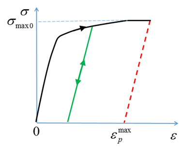

LAW2: Use Plastic Strain for Failure
In LAW2, the maximum plastic strain used for element failure. This means the shell element is
deleted once it reaches the maximum plastic strain defined in the model. Unlike
LAW27, there is no damage before failure and the failure can occur in both tension
and compression. Figure 1. Stress/Strain Curve for LAW2 with Maximum Plastic
Strain

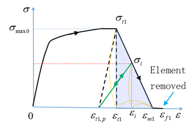

LAW27: Use a Damage Model
LAW27 is used to simulate material damage using a Johnson-Cook plasticity law. A
damage model is incorporated into the material law to take into account the damage
evolution where stress decreases up to element rupture. When using the material
failure included in LAW27, the failure and damage occur only in tension and not
compression.
The damage parameters in the principal direction are .
When the principal strain reaches , the material damage starts, based on the damage
face and , which are given by:(1)
In directions, .
The stress is then reduced using the damage parameter, .
The damage factor in the first principal direction is a function of principal
strain:(2) Figure 2. Stress/Strain Curve for Damage Affected Material

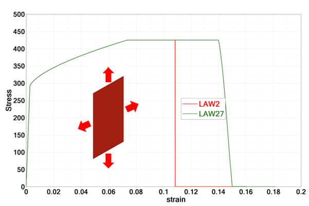

In order to show the difference between LAW2 and LAW27, uniaxial and eqibiaxial loads
are applied to a one element shell model.
Test 1: Uniaxial test
With
In LAW27, are total strain.
In LAW2, is plastic strain.
In one shell element set:
In LAW27,
In LAW2,
So that element deleted at same strain.(3)

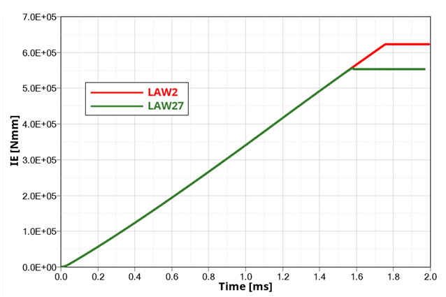

Although the element is deleted at same strain
the internal energy at failure is different for LAW2 and LAW27, due to
the difference the failure treatment. Figure 3. Stress versus Strain Curve . showing the failure strain in LAW2 and LAW27 Figure 4. Internal Energy Curve of the Element in LAW2 and
LAW27

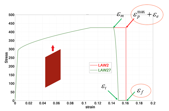

Test 2: Equibiaxial test
The failure strain values from the uniaxial test
are used in a equibiaxial test.
In LAW27,
In LAW2,
Figure 5. Stress/Plastic Strain Curve for LAW2 and
LAW27
In biaxial loading, the element deletion is different for LAW2
and LAW27, due to different failure treatment in LAW2 and LAW27. In
LAW2, the element is deleted when is reached in the element. The change in
plastic strain is:(4)
In LAW27, the element is deleted when the strain in each principal direction exceeds . The first principal strain in LAW27
is:(5)
The second principal strain is calculated in a similar manner.

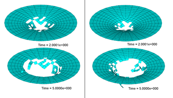

Plate Impact Model
If the previous failure strains definitions in a plate example is used, the results
are also different. Figure 6. Failure Behavior in Plate Test. left: LAW2; right: LAW27
The previous one element biaxial tension test showed the differences in LAW2 and
LAW27 in tension. Since LAW27 does not fail in compression, but LAW2 does fail in
compression, this causes a difference in the plate example shown in Figure 6.
