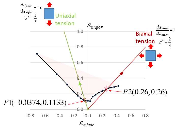

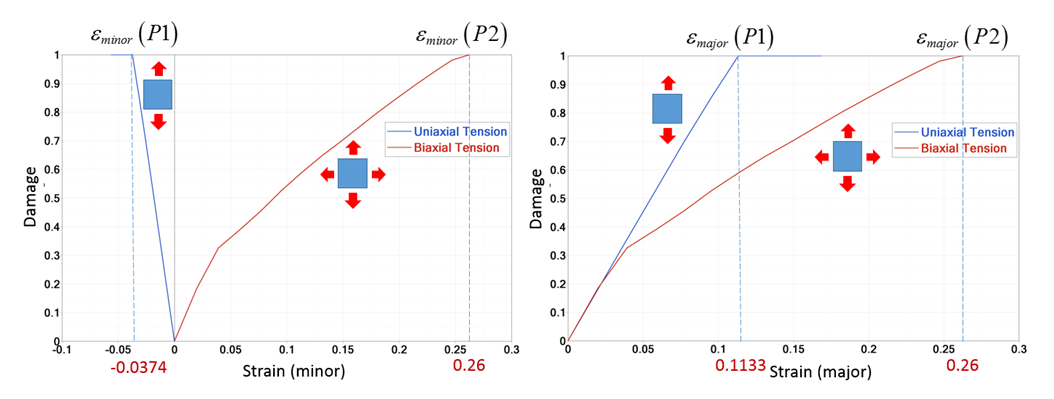

FLD Failure Model (Forming Limit Diagram)
- In uniaxial test (by ) once point P1 (-0.0374,0.1133) is reached, the element fails
- In eqibiaxial test (by ) once point P2(0.26,0.26) is reached, the element fails
Figure 3.
Only with /ANIM/SHELL/FLDF and Ifail_sh=4 is it possible to compute just the damage and not delete the element. It used to have a better vision of dangerous zones.

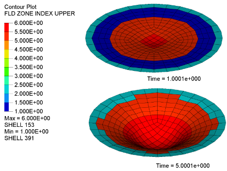

Figure 5. Failure zone
- FLDZ=6
- Failure
- FLDZ=5
- Marginal
- FLDZ=4
- Safe
- FLDZ=3
- Compression
- FLDZ=2
- High wrinkle
- FLDZ=1
- Loose metal
Figure 6. Failure zone in plate test
