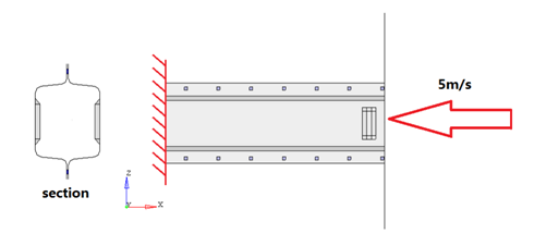

A steel crash box with solid spotweld, fixed at one end, is impacted at the other end by a rigid wall. The dimensions of the crash box are 333.6 mm x 122.7 mm x 68.28 mm, and its thickness is 1.8 mm.
ex48_problem_description
Figure 2. Problem Description and Beam Cross Section
Units: mm, s, Mg , N , MPa

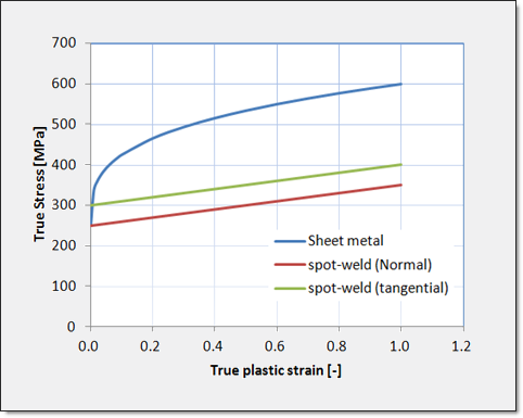

In this connection material (/MAT/LAW59) use stress - plastic strain curve to describe the material characters of spot-weld. With failure model (/FAIL/CONNECT) it is possible to use two different failure criteria to describe the failure of solid spot.
In this example, use the following characteristics:
Material Properties
Value
Initial density
7.8e-9 [Mg/mm3]
Young's modulus
210000 [ MPa ] MathType@MTEF@5@5@+= feaagKart1ev2aqatCvAUfeBSjuyZL2yd9gzLbvyNv2CaerbuLwBLn hiov2DGi1BTfMBaeXatLxBI9gBaerbd9wDYLwzYbItLDharqqtubsr 4rNCHbGeaGqiVu0Je9sqqrpepC0xbbL8F4rqGqFfpeea0xe9vq=Jb9 vqpeea0xd9q8qiYRWxGi6xij=hbba9q8aq0=yq=He9q8qiLsFr0=vr 0=vr0db8meaabaqaciGacaGaaeqabaWaaeaaeaaakeaadaWadaqaai Gac2eacaGGqbGaaiyyaaGaay5waiaaw2faaaaa@3BE6@
Failure relative displacement in normal direction
1.0
Failure relative displacement in tangential plane
1.8
ex48_material_curve
Figure 3. Material Curve of Sheet Metal and Solid Spotweld
In this example a linear behavior of spotweld has just been assumed. For more accurate results, you can also put nonlinear behavior of spotweld through real physic test and CAE validation.

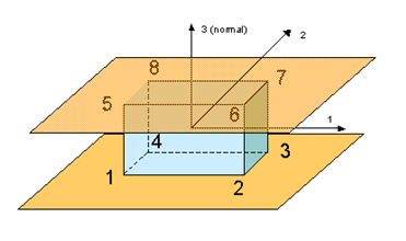

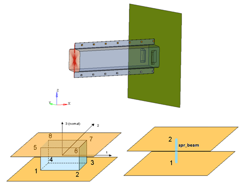

Solid spotweld will be modeled as:
  • /MAT/LAW59 to define the material
  • /FAIL/CONNECT to define the rupture criteria
  • /PROP/TYPE43 to define the spotweld property, which should be only used with /MAT/LAW59
  • /INTER/TYPE2 to define the connection between spotweld and sheet metal
Note:
  1. In this spotweld modeling surface 1 (Node 1, 2, 3, and 4) and surface 2 (Node 5, 6, 7, and 8) are defined. The normal direction has been defined from surface 1 to surface 2.
  2. Surface 1 and 2 for each solid spotweld should always connect with a shell element. If one surface of one solid spotweld is not connected with a shell element, then the stiffness will not be computed correctly and an error may occur.

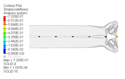

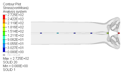

With /ANIM/BRICK/TENS/STRAIN and /ANIM/BRICK/TENS/STRESS you get the strain and stress results of the solid spotweld (Figure 5, Figure 6).
ex48_spotweld_strain
Figure 5. Strain of Solid Spotweld
ex48_spotweld_stress
Figure 6. Stress of Solid Spotweld

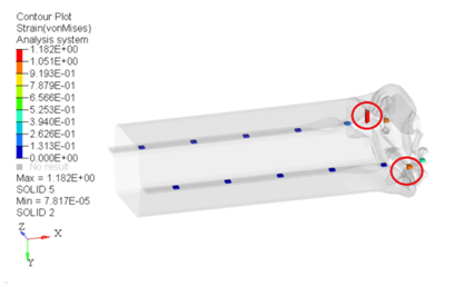

Here in the model you define max. relative displacement in normal direction EPS_N_MAX=1.0 in option /FAIL/CONNECT. Therefore, two solid spotwelds (circled in red) failed after reaching this criterion.

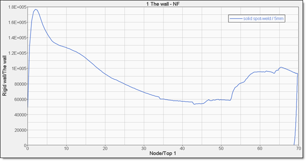

ex48_force_vs_disp
Figure 8. Force versus Displacement of Crashbox

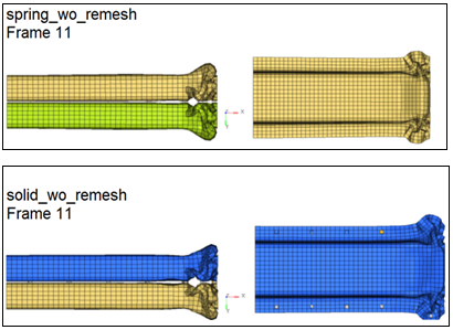

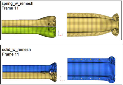

Compared with spring beam spotweld molding, the following performance could be observed:
If you use this solid spotweld modeling, it shows less sheet metal mesh size dependence compared with spring beam element.
  • With coarse sheet metal mesh size, you got similar deformation and similar Force versus Displacement curve for solid spotweld modeling and spring beam spotweld modeling.
    ex48_performance
    Figure 9.
  • Once you remesh the sheet metal shell element with fine mesh size (for example with 2.5mm mesh size here), then you still get similar deformation and Force versus Displacement curve in solid spotweld modeling but not in spring beam spotweld modeling. This means less sheet metal mesh size dependence for this new solid spotweld modeling.
    ex48_performance2
    Figure 10.
