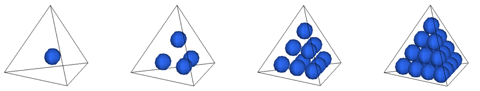

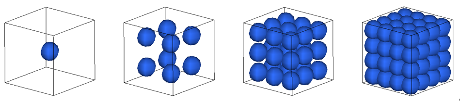

- Number of particles created for each direction, the maximum value is 9
| Ndir = 1: 1 particle is created | Ndir = 2: 8 particles are created | Ndir = 3: 27 particles are created | Ndir = 4: 64 particles are created |
| Ndir = 1: 1 particle is created | Ndir = 2: 4 particles are created | Ndir = 3: 10 particles are created | Ndir = 4: 22 particles are created |
