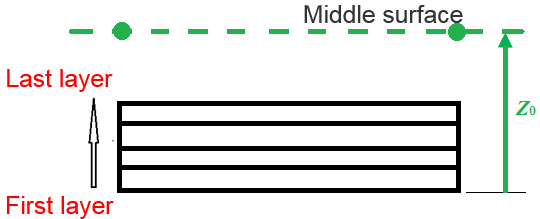

Z0 | Distance from the shell
element reference plane to the bottom surface of the shell (Real or
blank). It should be considered, if Ipos =2. Default = 0.0 (Real) |

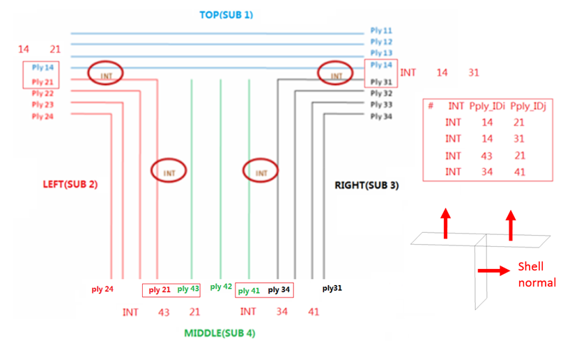

INT | Indicates the connection between 2 substacks (must be left
justified). (Integer) |
Pply_IDt | Ply
identification number of the top ply of the bottom substack. One
of ply ID in
Pply_IDi or
Pply_IDj. (Integer) |
Pply_IDb | Ply
identification number of the bottom ply of the top substack. One of ply ID in
Pply_IDi
or
Example (Substack with /DRAPE)
/UNIT/1
unit for mat
Mg mm s
/PROP/PCOMPP/1/1
PCOMPP example
/STACK/1/1
NEW_PROP_1
# Ishell Ismstr Ish3n Idril Z0
12 0 0 0 0
# hm hf hr dm dn
0 0 0 0 0
# Istrain Ashear Iint Ithick
0 0 1 0
# VX VY VZ skew_ID Iorth Ipos Ip
0 1 0 0 0 0 0
# Sub Nsub Sub-plyn
SUB 1 4
# Substack Name
TOP
# Pply_IDi PHIi Zi
11 45 0
# Pply_IDi PHIi Zi
12 -45 0
# Pply_IDi PHIi Zi
13 90 0
# Pply_IDi PHIi Zi
14 90 0
# Sub Nsub Sub-plyn
SUB 2 4
# Substack Name
LEFT
# Pply_IDi PHIi Zi
21 45 0
# Pply_IDi PHIi Zi
22 -45 0
# Pply_IDi PHIi Zi
23 90 0
# Pply_IDi PHIi Zi
24 90 0
# Sub Nsub Sub-plyn
SUB 3 4
# Substack Name
RIGHT
# Pply_IDi PHIi Zi
31 45 0
# Pply_IDi PHIi Zi
32 -45 0
# Pply_IDi PHIi Zi
33 90 0
# Pply_IDi PHIi Zi
34 90 0
# Sub Nsub Sub-plyn
SUB 4 3
# Substack Name
MIDDLE
# Pply_IDi PHIi Zi
41 45 0
# Pply_IDi PHIi Zi
42 -45 0
# Pply_IDi PHIi Zi
43 90 0
# Int Pply_IDt Pply_IDb
INT 14 21
INT 14 31
INT 43 21
INT 34 41

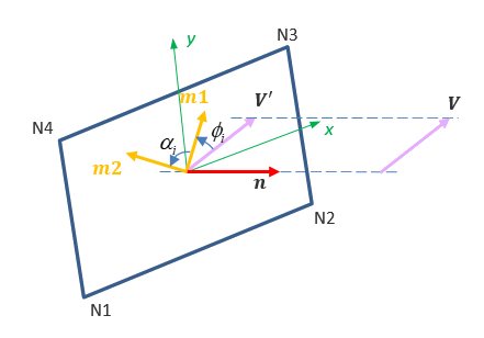

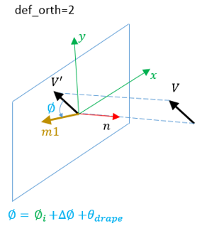

- Anisotropy direction
definition.The reference vector is defined as following according flag IP:
- If IP=0 and skew_ID = 0, the reference vector is defined with VX, VY and VZ.
- If IP=0 and skew_ID ≠ 0, the reference vector is the first direction (local X) of the local coordinate system skew_ID.
- If IP = 20, the reference vector is defined with the node N1 and N2 of the shell elements.
- If IP = 22, the reference vector is the first direction (local X) of the local coordinate system skew_ID. Vector components VX, VY and VZ are ignored.
- If IP = 23, the reference vector is defined with VX, VY and VZ. Local coordinate system skew_ID is ignored.
The reference vector is projected on the shell element plane and becomes the vector . Then for each layer, the 1st material direction (m1) is vector turned degrees (turns positive direction around shell normal ).
Figure 3.The hierarchy order to define the reference vector is:- shell element ( > 0 in either /SHELL or /SH3N)
- initial state card (/INISHE/ORTHO)
- shell property
In case of reference metrics, the orientation for directions of anisotropy must be defined with the reference geometry, not the initial one. The 2nd material direction m2 is derived from direction m1 with the angle (defined in /PLY). If , the layer is orthotropic.

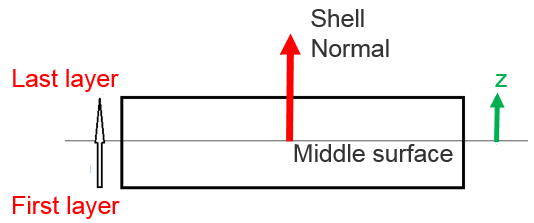

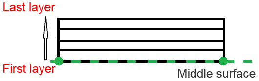

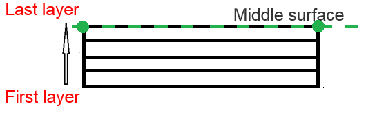

- Ipos - ply position
- In this property, ply position defined with and option Ipos.
- values are real ply positions in the local Z axis (negative and positive value are allowed and defines the position of the middle of the each ply).
- only used with Ipos=2, it indicated distance from the shell element reference middle surface to the bottom surface of the whole ply or stack. For additional information, see Ipos=2
- Ipos = 0: ply positions are
automatically calculated with regard to ply thicknesses.
- The input thickness “Thick” may be equal to zero as the true shell thickness is always calculated from the ply thicknesses and positions of ply defined by .

- Ipos = 2: the shell element
mid-surface is at
from the bottom of the ply layout.
Figure 5. - Ipos = 3: the top of the ply layout
is coincident with the element mid-surface.
Figure 6. - Ipos = 4: the bottom of the ply
layout is coincident with the element mid-surface.
Figure 7.
- Define by substack.
- If the substack definition is used, each substack definition begins with the keyword "SUB" and the substack identification number.
- All the plies until the next keyword "SUB" or the keyword "INT" is encountered belong to the same substack.
- All substacks must be defined before defining the “INT connections
- If an element contains plies belonging to several substacks, the connection between the substacks is defined with an “INT” connection: the ply Pply_IDt of the first substack is connected to the ply Pply_IDb of the second substack.
- For additioinal inforation, refer to the above examples for this property.
