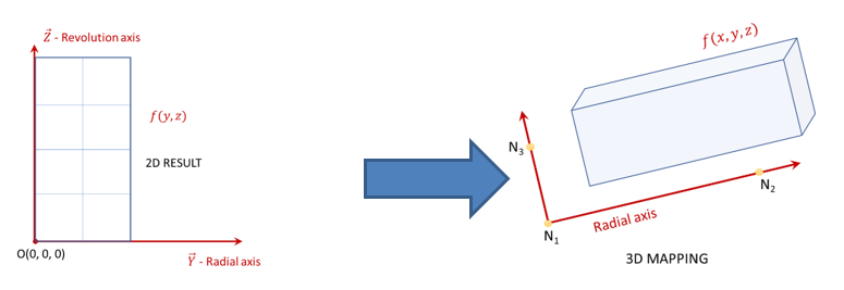

- Generated data can
be used subsequently in a target model using /INIMAP2D/VP,
/INIMAP2D/VE or /INIMAP2D/FILE. In the
target model, a frame will have to be defined and must be consistent with
mapping data, as described below:
Figure 1.2D Original Model 3D Target Model
