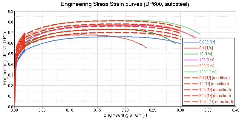

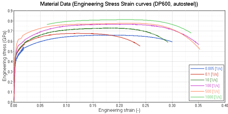

Figure 2. Material Data of Engineering Stress versus Strain for Different Strain Rates. (Steel DP600, original data from autosteel)

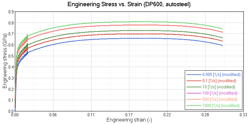

Figure 3. Original and Modified Engineering Stress versus Strain Curves for Different Strain Rates. (Steel DP600, autosteel)
Figure 4. Modified Engineering Stress Strain Curves for Different Strain Rates

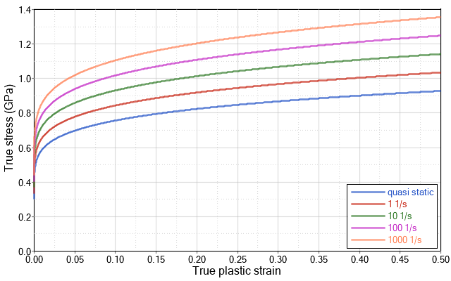

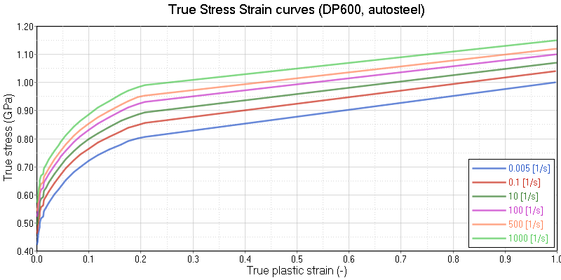

Figure 5. True Stress versus True Plastic Strain Curves for Different Strain Rates

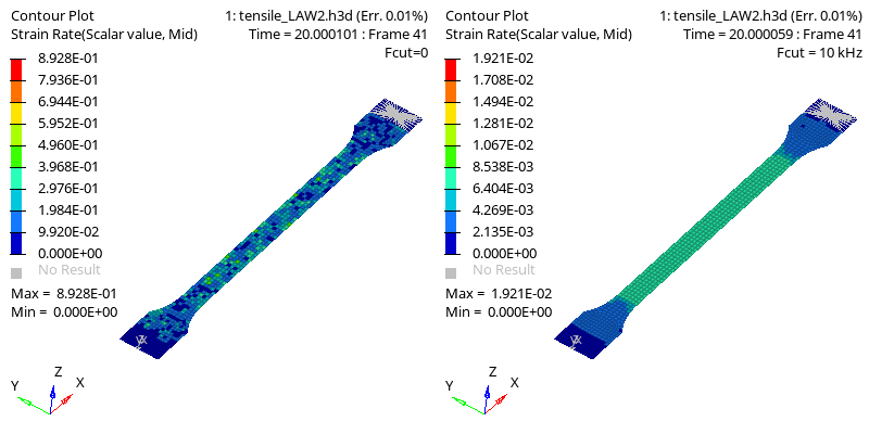

/MAT/LAW2 with Strain Rate Effect
Figure 6. Comparison of the Distribution of the Strain Rate in the Specimen without Strain Rate Filtering (Fcut=0) . and with strain rate filtering (Fsmooth=1 and Fcut=10 kHz)

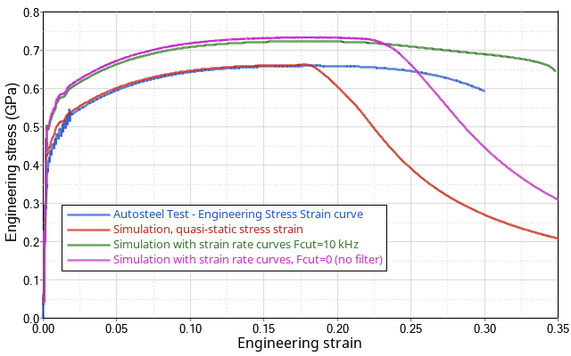

The explicit scheme is an element-by-element method and the local treatment of temporal oscillations puts spatial oscillations into the model. A more physical strain rate distribution is achieved by filtering. Moreover, such results show oscillations in the stress strain curve when not damped by filtering.
Figure 7. Engineering Stress Strain Curves with and without Strain Rate Filtering /MAT/LAW2

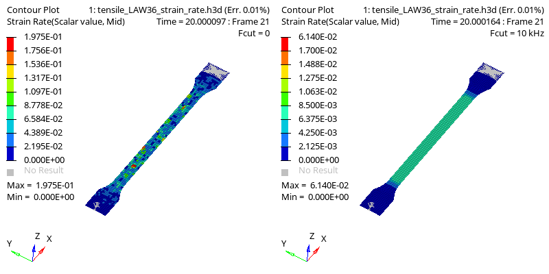

/MAT/LAW36 with Strain Rate Effect
Figure 8. Comparison of the Distribution of the Strain Rate in the Specimen, with and without Strain Rate Filtering /MAT/LAW36

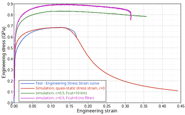

Figure 9. Comparison of the Distribution of the Strain Rate in the Specimen, with and without Strain Rate Filtering (/MAT/LAW36) . and engineering stress strain curves without strain rate
As shown in Figure 9, a strain rate larger than the quasi-static test causes the material to be stiffer. The quasi-static and case without a filter, experience material necking which results in the reduction in stress.
