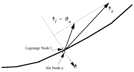

TYPE1 interface is used to model fluid-structure interactions, as shown in Figure 1.
Figure 1. Fluid-Structure Interaction
This interface allows Lagrangian elements (structure) to interact with ALE (Arbitrary Lagrangian Eulerian) elements, which model a viscous fluid. Full slip conditions are applied at the boundary between the two domains.

The grid velocity of the ALE node is equal to the material velocity of the Lagrange node:(3)
w → a = v → i MathType@MTEF@5@5@+= feaagKart1ev2aaatCvAUfeBSjuyZL2yd9gzLbvyNv2CaerbwvMCKf MBHbqefqvATv2CG4uz3bIuV1wyUbqedmvETj2BSbqefm0B1jxALjhi ov2DaebbnrfifHhDYfgasaacH8srps0lbbf9q8WrFfeuY=Hhbbf9v8 qqaqFr0xc9pk0xbba9q8WqFfea0=yr0RYxir=Jbba9q8aq0=yq=He9 q8qqQ8frFve9Fve9Ff0dmeaacaGacmGadaWaaiqacaabaiaafaaake aaceWG3bGbaSaadaWgaaWcbaGaamyyaaqabaGccqGH9aqpceWG2bGb aSaadaWgaaWcbaGaamyAaaqabaaaaa@3E2E@
The normal material velocities of Lagrange and ALE nodes are equal. Therefore:(4)
v → a ⋅ n → = v → i ⋅ n → MathType@MTEF@5@5@+= feaagKart1ev2aaatCvAUfeBSjuyZL2yd9gzLbvyNv2CaerbwvMCKf MBHbqefqvATv2CG4uz3bIuV1wyUbqedmvETj2BSbqefm0B1jxALjhi ov2DaebbnrfifHhDYfgasaacH8srps0lbbf9q8WrFfeuY=Hhbbf9v8 qqaqFr0xc9pk0xbba9q8WqFfea0=yr0RYxir=Jbba9q8aq0=yq=He9 q8qqQ8frFve9Fve9Ff0dmeaacaGacmGadaWaaiqacaabaiaafaaake aaceWG2bGbaSaadaWgaaWcbaGaamyyaaqabaGccqGHflY1ceWGUbGb aSaacqGH9aqpceWG2bGbaSaadaWgaaWcbaGaamyAaaqabaGccqGHfl Y1ceWGUbGbaSaaaaa@44D5@
