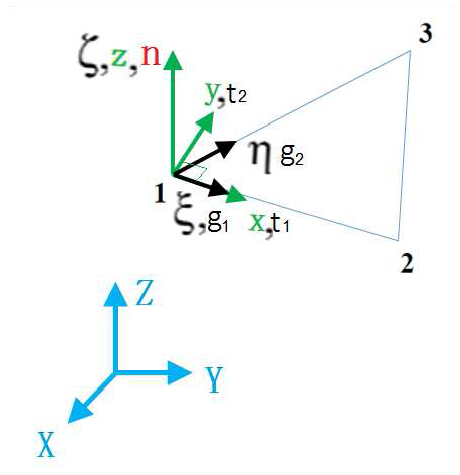

Local Reference Frame
The local reference frame for the three node shell element is shown in Figure 1. Figure 1. Node Shell Local Reference Frame
The vector normal to the plane of the element is defined as:(1)
The vector defining the local x direction is defined as edge 1-2:(2)
Hence, the vector defining the local y direction is found from the cross product of the two
previous vectors:(3)
