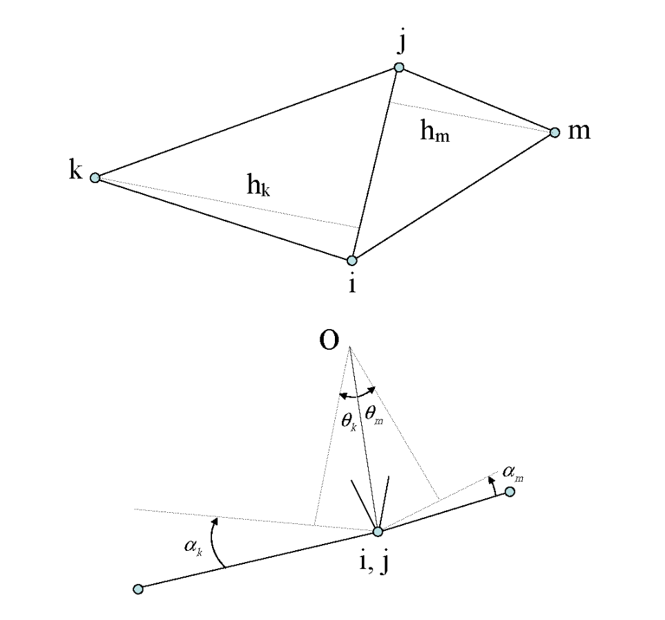

Consider two adjacent coplanar elements with a common edge i-j as shown in Figure 2. Due to out-of-plane displacements of nodes and , the elements rotate around the side i-j. The angles between
final and initial positions of the elements are respectively and for corresponding opposite nodes and . Assuming, a constant curvature for both of elements, the
rotation angles and related to the bending of each element around the common side
are obtained by:(1)
However, for total rotation you have:(2)
which leads to:(3)
Figure 1. Computation of Rotational DOF in SH3N6

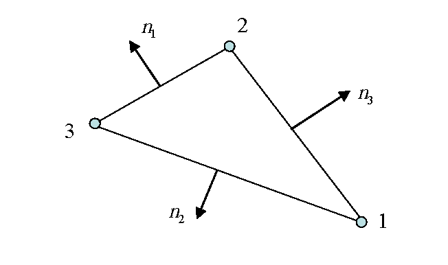

Consider the triangle element in Figure 2. The outward normal vectors at the three sides are defined and denoted , and . The normal component strain due to the bending around the
element side is obtained using plate assumption:(4)

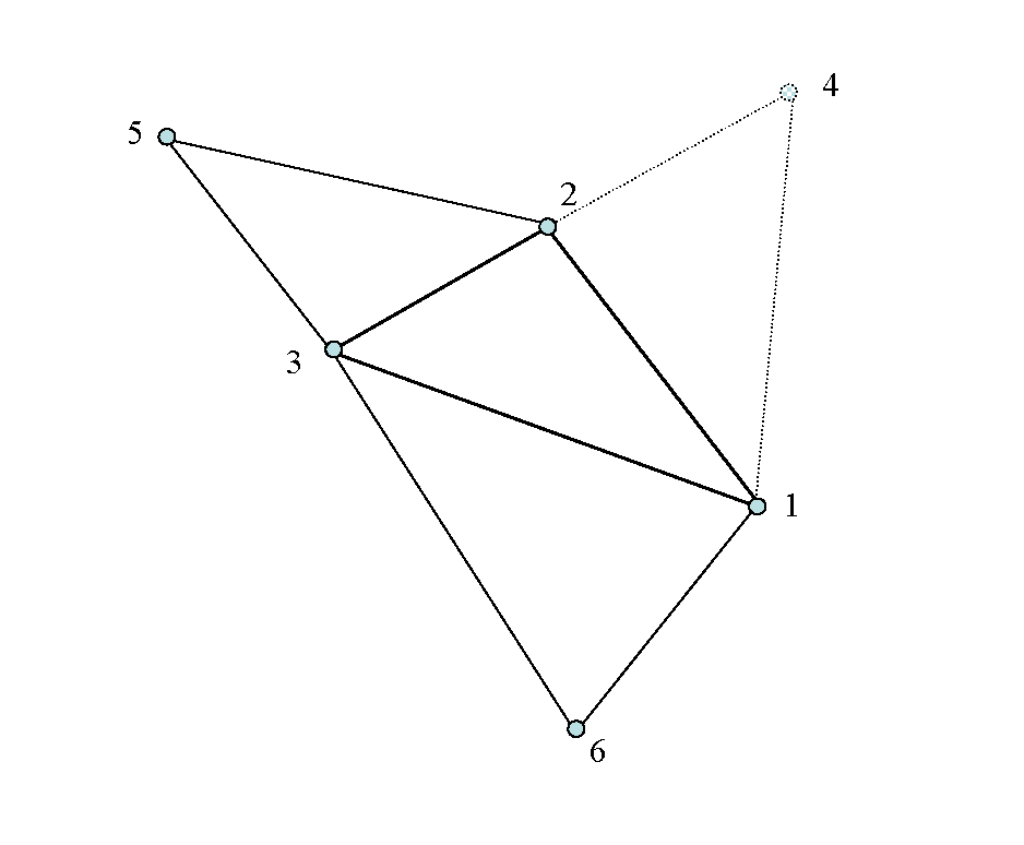

The six mid-side rotations are related to the out-of-plane displacements of the six apex nodes as
shown in Figure 3 by the following relation:(5)
Where, , ,
and are respectively the heights of the triangles (1,2,3), (1,4,2), (2,5,3)
and (3,6,1). Figure 2. Normal Vectors Definition
The non-null components of strain tensor in the local element reference are related to the
normal components of strain by the following relation: 13(6)
Figure 3. Neighbor Elements for a Triangle

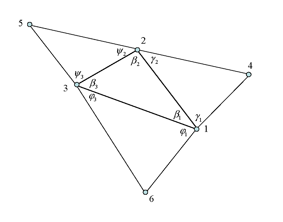

As the side rotation of the element is computed using the out-of-plane displacement of the
neighbor elements, the application of clamped or free boundary conditions needs a particular
attention. It is natural to consider the boundary conditions on the edges by introducing a
virtual and symmetric element outside of the edge as described in Figure 4. In the case of free rotation at the edge, the
normal strain is vanished. From Equation 4, this leads
to:(7)
In Equation 5 the fourth row of the
matrix is then changed to:(8)
The clamped condition is introduced by the symmetry in out-of-plane displacement, that is, . This implies . The fourth row of the matrix in Equation 5 is then changed
to:(9)
Figure 4. Virtual Element Definition for Boundary Conditions Application
