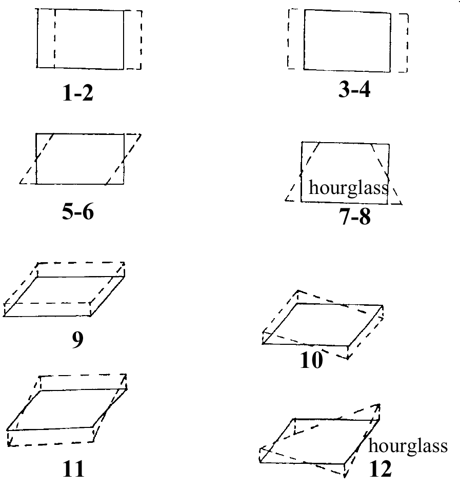

Hourglass modes are element distortions that have zero strain energy. The 4 node shell
element has 12 translational modes, 3 rigid body modes (1, 2, 9), 6 deformation modes (3, 4,
5, 6, 10, 11) and 3 hourglass modes (7, 8, 12). Figure 1. Translational Modes of Shell

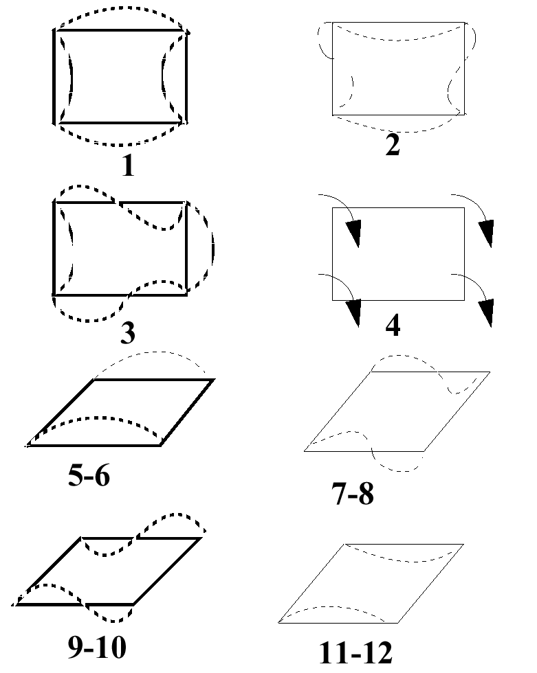

Along with the translational modes, the 4 node shell has 12 rotational modes: 4 out of
plane rotation modes (1, 2, 3, 4), 2 deformation modes (5, 6), 2 rigid body or deformation
modes (7, 8) and 4 hourglass modes (9, 10, 11, 12). Figure 2. Rotational Modes of Shell
