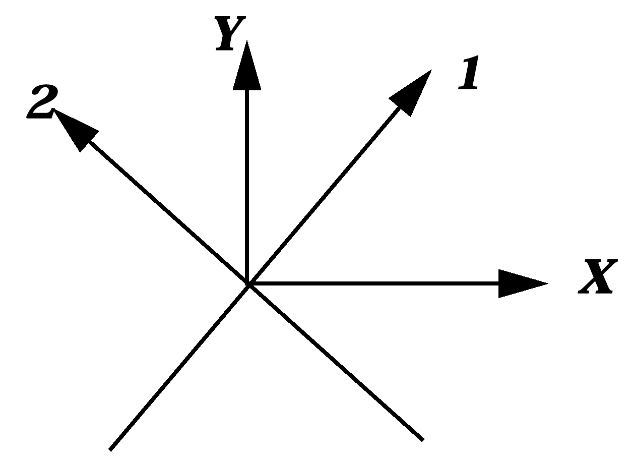

If the element reference is defined by the axes X, Y and the orthotropy directions by axes 1-2, write:
Figure 1. Fiber Orientation

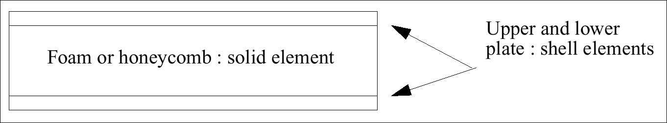

Solid + Shell Elements
For sandwich plates, if the foam or the honeycomb is very thick, it is possible to combine composite shells for the plates and solid elements for the sandwich.

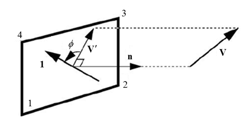

A global reference vector V MathType@MTEF@5@5@+= feaagKart1ev2aqatCvAUfeBSjuyZL2yd9gzLbvyNv2CaerbuLwBLn hiov2DGi1BTfMBaeXatLxBI9gBaerbd9wDYLwzYbItLDharqqtubsr 4rNCHbGeaGqiVu0Je9sqqrpepC0xbbL8F4rqqrFfpeea0xe9Lq=Jc9 vqaqpepm0xbba9pwe9Q8fs0=yqaqpepae9pg0FirpepeKkFr0xfr=x fr=xb9adbaqaaeGaciGaaiaabeqaamaabaabaaGcbaGaaCOvaaaa@36D6@ is used to define the fiber direction. The direction in which the material properties (or fiber direction) lay is known as the direction 1 of the local coordinate system of orthotropy. It is defined by the ϕ angle, which is the angle between the local direction 1 (fiber direction) and the projection of the global vector V MathType@MTEF@5@5@+= feaagKart1ev2aqatCvAUfeBSjuyZL2yd9gzLbvyNv2CaerbuLwBLn hiov2DGi1BTfMBaeXatLxBI9gBaerbd9wDYLwzYbItLDharqqtubsr 4rNCHbGeaGqiVu0Je9sqqrpepC0xbbL8F4rqqrFfpeea0xe9Lq=Jc9 vqaqpepm0xbba9pwe9Q8fs0=yqaqpepae9pg0FirpepeKkFr0xfr=x fr=xb9adbaqaaeGaciGaaiaabeqaamaabaabaaGcbaGaaCOvaaaa@36D6@ as shown in Figure 3.
Figure 3. Fiber Direction Orientation
The shell normal defines the positive direction for ϕ . For elements with more than one layer, multiple ϕ angles can be defined.

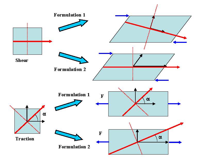

The fiber direction orientation may be updated by two different ways:
  1. Constant orientation in local corotational reference frame constant orientation in local isoparametric frame. The first formulation may lead to unstable models especially in the case of very thin shells (airbag modeling). In Figure 4 the difference between the two formulations is illustrated for the case of element traction and shearing.
Figure 4. Fiber Direction Updating
