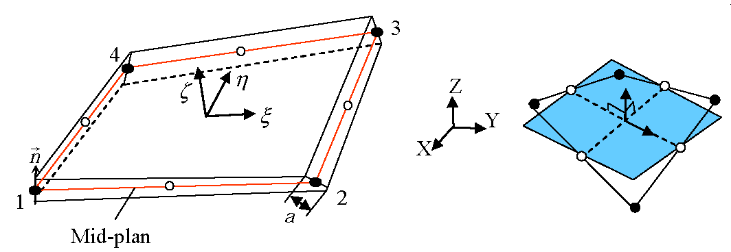

Geometry and Kinematics
Figure 1. Coordinate Systems
The geometry of the 4-node degenerated shell element, as shown in Figure 1, is defined by its mid-surface with coordinates denoted by interpolated by the node coordinates (=1,4):(1)
Where, are the bilinear isoparametric shape functions, given
by:(2)
A generic point within the shell is derived
from point p on the mid-surface and its coordinate along the normal (fiber):(3)
with
Where,
Shell thickness
The transformation between the Cartesian system and the Natural system is given by the
differential relation (in matrix form):(4)
with
is the gradient tensor which is related to the Jacobian tensor .
With 5 DOF at each node I (three translational velocities and two rotational velocities , the velocity interpolation is given by the Mindlin
model:(5)
Where, and are the rotational velocity vectors of the normal:
This velocity interpolation is expressed in the global system, but
must be defined first in the local nodal
coordinate system to ensure Mindlin's kinematic condition.

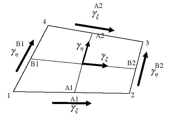

The out-plane rate-of-deformation (transverse shear) is interpolated by the "assumed
strain" method, which is based on the Hu-Washizu variation principle.
If the out-plane rate-of-deformation is interpolated in the same manner for a full
integration scheme, it will lead to shear locking. It is known that the
transverse shear strains energy cannot vanish when it is subjected to a constant bending
moment. Dvorkin-Bathe's 1 mix/collocation method has been proved very
efficient in overcoming this problem. This method consists in interpolating the transverse
shear from the values of the covariant components of the transverse shear strains at 4
mid-side points. That is:(9)
(10)
Where, are the values of the covariant components at 4 mid-side
points which vanish under a constant bending moment (Figure 2). Figure 2. Covariant Components at 4 Mid-Side
