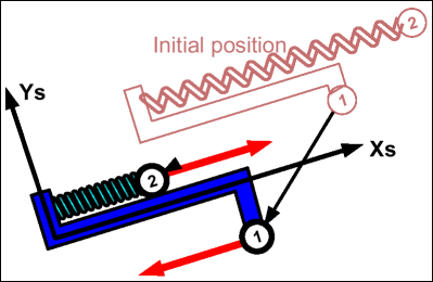

To help understand the use of skew frames, the deformation in the local x direction of the spring
will be considered. If the skew frame is fixed, deformation in the local X direction is shown in
Figure 1: Figure 1. Fixed Skew Frame

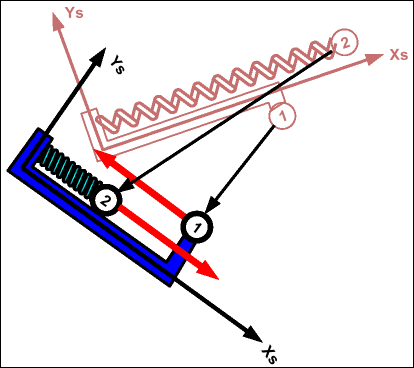

The same local x direction deformation, with a moving skew frame, can be seen in Figure 2. Figure 2. Moving Skew Frame
In both cases, the forces are in equilibrium, but the moments are not. If the first two nodes
defining the moving skew system are the same nodes as the two spring element nodes, the behavior
becomes exactly the same as that of a TYPE4 spring element. In this case the momentum
equilibrium is respected and local Y and Z deformations are always equal to zero.

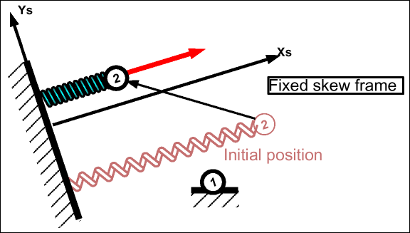

Fixed Nodes
If one of the two nodes is
completely fixed, the momentum equilibrium problem disappears. For example, if node 1 is fixed,
the force computation at node 2 is not dependent on the location of node 1. The spring then
becomes a spring between node 1 and the laboratory, as shown in Figure 3. Figure 3. Fixed Node - Fixed Skew Frame
It is generally recommended that a general spring element (TYPE8) be used only if
one node is fixed in all directions or if the two nodes are coincident. If the two nodes are
coincident, the translational stiffness' have to be large enough to ensure that the nodes
remain near coincident during the simulation.

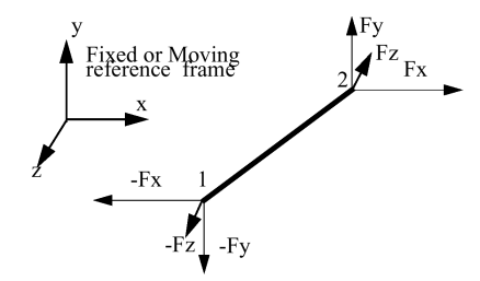

Translational Forces
The translational forces that can be applied to a general spring element can be seen in Figure 4. For each DOF (i = x, y, z), the force is calculated
by:(3)
Where,
Equivalent viscous damping coefficient
Force function related to spring displacement
The value of the displacement function depends on the type of general spring being modeled. Figure 4. Translational Forces
