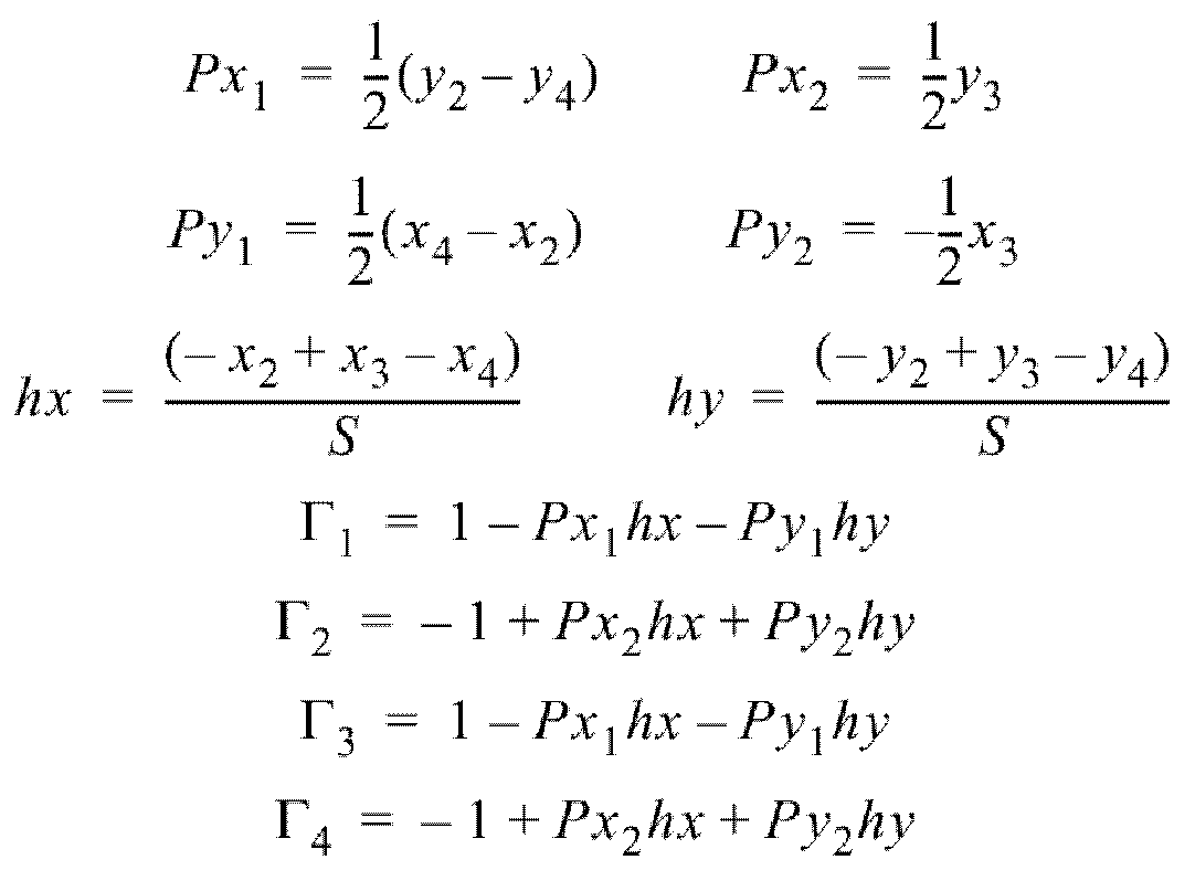

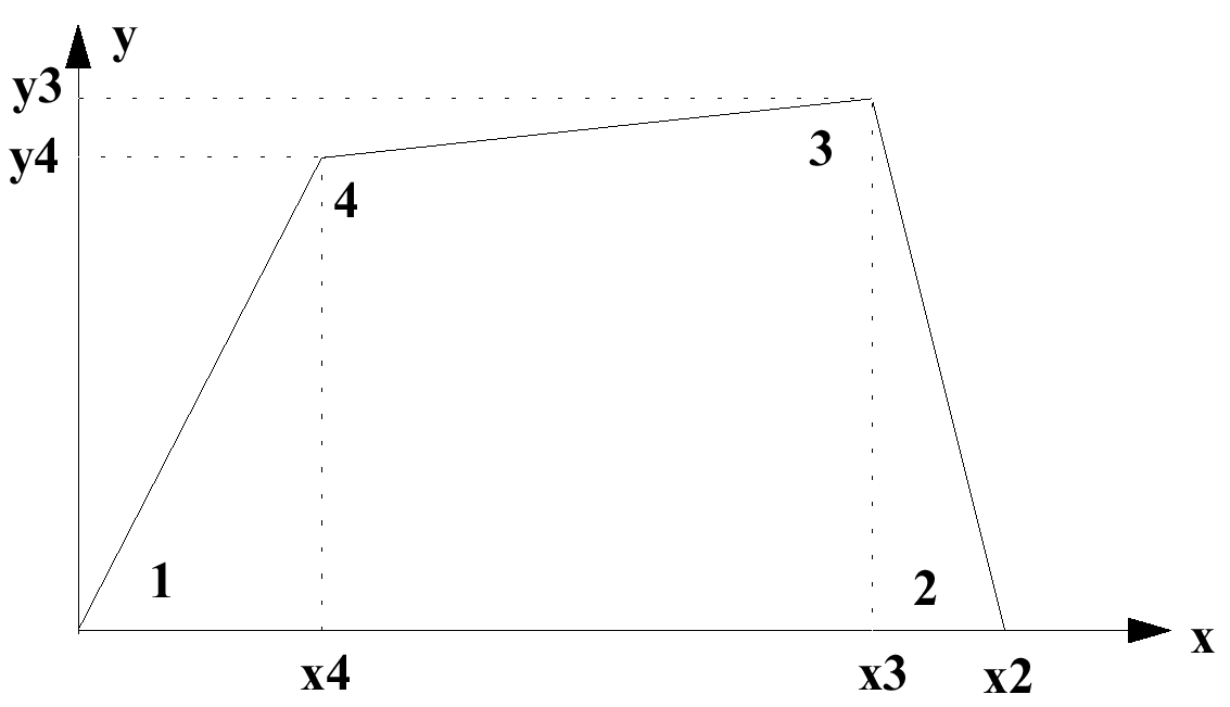

In the Kosloff-Frasier formulation seen in Kosloff and Frasier Formulation, the hourglass base vector is not perfectly orthogonal to the rigid body and deformation
modes that are taken into account by the one point integration scheme. The mean
stress/strain formulation of a one point integration scheme only considers a fully linear
velocity field, so that the physical element modes generally contribute to the hourglass
energy. To avoid this, the idea in the Flanagan-Belytschko formulation is to build an
hourglass velocity field which always remains orthogonal to the physical element modes. This
can be written as:(1)
The linear portion of the velocity field can be expanded to give:(2)
Decomposition on the hourglass base vectors gives 1:(3)
is the hourglass shape vector used in place of in Hourglass Modes, Equation 2. Figure 1. Flanagan Belytschko Hourglass Formulation
