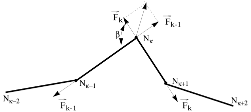

Internal Forces Computation
Figure 1. Internal Forces Computation
Nodes are numbered from 1 to , and strands are numbered from 1 to n-1 (strand goes from node Nk to node Nk+1).

Force into each Strand
The force into each strand is computed as:
Where, is computed an incremental way:(3)
with the length of the unconstrained strand , and .
Where, is the unitary vector from node Nk to node
Nk+1.
Friction is expressed at the nodes: if is the friction coefficient at node , the pulley friction at node Nk is expressed
as:(6)
When equation Equation 6 is not satisfied, is reset to .
All the (k=1, n-1) are modified in order to satisfy all conditions upon (k=2, n-1), plus the following condition on the force integral
along the multistrand element:(7)
This process could fail to satisfy Equation 6 after the modification, since no iteration is made. However, in such a case
one would expect the friction condition to be satisfied after a few time steps.
Note: Friction expressed upon strands (giving a friction coefficient along strand ) is related to pulley friction by adding a friction coefficient upon each nodes Nk and Nk+1.
