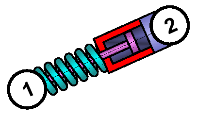

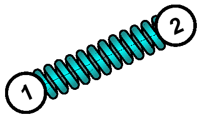

One degree of freedom (DOF) spring elements are defined as a TYPE4 property set. Three variations
of the element are possible:
Spring only
Dashpot (damper) only
Spring and dashpot in parallel
These three configurations are shown in Figure 1 to Figure 3. Figure 1. Spring Only Figure 2. Dashpot Only Figure 3. Spring and Dashpot in Parallel

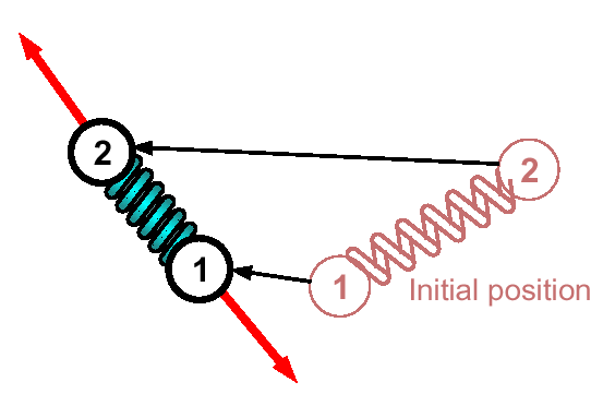

A spring may also have zero length. However, a one DOF spring must have 2 nodes.
The forces applied on the nodes of a one DOF spring are always colinear with direction through
both nodes; refer to Figure 4. Figure 4. Colinear Forces

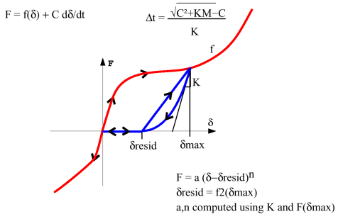

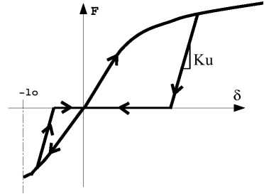

The hardening flag is set to 5 in this
case and and (maximum yield force and residual deformation, respectively) are
defined by a function. Uncoupled hardening in compression and tensile behavior with nonlinear
unloading:(12)
With . Figure 10. Nonlinear Unloading Force-Displacement Curve

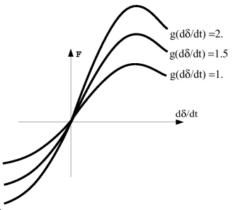

The hardening flag in the input must be set to equal zero. The force relationship is given
by:(16)
Graphs of this relationship for various values of are shown in Figure 12. Figure 12. Visco-Elastic Spring Force-Displacement Curves
