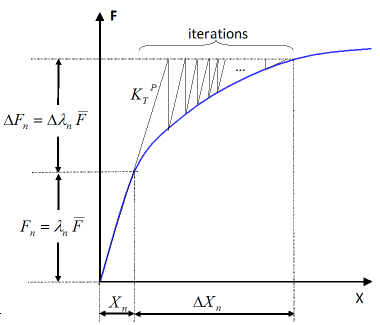

Using load control technique, the standard Newton-Raphson method resolves Equation 9 to Equation 11 by applying a known load increment Δ λ as illustrated in Figure 1. The tangent matrix is updated and triangulized at each iteration. This insures a quadratic convergence to exact solution.
Figure 1. Standard Newton-Raphson Resolution in the Case of Load Control Technique

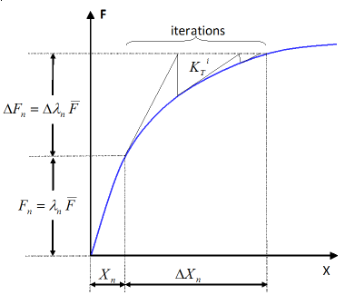

Figure 2. Modified Newton-Raphson Resolution in the Case of Load Control Technique
However, it is possible to save computation time which depends on the size of the problem and on the degree of the nonlinearity of the problem. The method is called modified Newton-Raphson which is based on the conservation of the tangent matrix for all iterations (Figure 2). This method can also be combined with the acceleration techniques as line-search explained in Line Search Method to Optimize the Resolution.

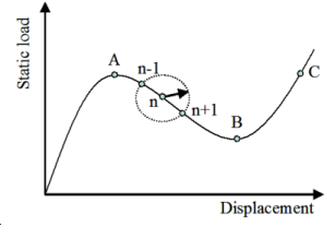

(c) Arc-length method: intersection of the equilibrium branch with the circle about the last solution

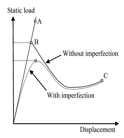

(d) Buckling with or without imperfections
The tracing of equilibrium branches are quite difficult. In arc-length method, instead of incrementing the load parameter, a measure of the arc length in the displacement-load parameter space is incremented. This is accomplished by adding a controlling parameter to the equilibrium equations.
The arc-length method was originally introduced by Riks 3 and Wempner. 4 Considering a function f MathType@MTEF@5@5@+= feaagKart1ev2aaatCvAUfeBSjuyZL2yd9gzLbvyNv2CaerbuLwBLn hiov2DGi1BTfMBaeXatLxBI9gBaerbd9wDYLwzYbItLDharqqtubsr 4rNCHbGeaGqiVu0Je9sqqrpepC0xbbL8F4rqqrFfpeea0xe9Lq=Jc9 vqaqpepm0xbba9pwe9Q8fs0=yqaqpepae9pg0FirpepeKkFr0xfr=x fr=xb9adbaqaaeGaciGaaiaabeqaamaabaabaaGcbaGaamOzaaaa@36E1@ implying several components of the displacement vector X MathType@MTEF@5@5@+= feaagKart1ev2aaatCvAUfeBSjuyZL2yd9gzLbvyNv2CaerbuLwBLn hiov2DGi1BTfMBaeXatLxBI9gBaerbd9wDYLwzYbItLDharqqtubsr 4rNCHbGeaGqiVu0Je9sqqrpepC0xbbL8F4rqqrFfpeea0xe9Lq=Jc9 vqaqpepm0xbba9pwe9Q8fs0=yqaqpepae9pg0FirpepeKkFr0xfr=x fr=xb9adbaqaaeGaciGaaiaabeqaamaabaabaaGcbaGaamOzaaaa@36E1@ , the arc-length method consists in determining in each step the Euclidian norm of the increase in X MathType@MTEF@5@5@+= feaagKart1ev2aaatCvAUfeBSjuyZL2yd9gzLbvyNv2CaerbuLwBLn hiov2DGi1BTfMBaeXatLxBI9gBaerbd9wDYLwzYbItLDharqqtubsr 4rNCHbGeaGqiVu0Je9sqqrpepC0xbbL8F4rqqrFfpeea0xe9Lq=Jc9 vqaqpepm0xbba9pwe9Q8fs0=yqaqpepae9pg0FirpepeKkFr0xfr=x fr=xb9adbaqaaeGaciGaaiaabeqaamaabaabaaGcbaGaamOzaaaa@36E1@ :(18) f = 〈 X i + 1 − X n 〉 { X i + 1 − X n } − ( Δ S n ) 2 = 0
This leads to:(19) 〈 X i + 1 − X n 〉 { X i + 1 − X n } = ( Δ S n ) 2
And (20) a ( Δ λ ) 2 + b ( Δ λ ) + c = 0
With:
a = 〈 Δ X F 〉 { Δ X F } ; { Δ X F } = [ K T n ] − 1 { F e x t }
b = 2 〈 Δ X F 〉 { Y } ; { Y } = { Δ X F } + { X i − X n }
c = 〈 Y 〉 { Y } − ( Δ S n ) 2
In each of the Newton-Raphson iterations, Equation 20 must be resolved to select a real root. If there is no root, Δ S n should be reduced. The most closed root to the last solution is retained in the case of two real roots.
Table 1(c) illustrates the intersection of the equilibrium branch with the circle about the last solution.
