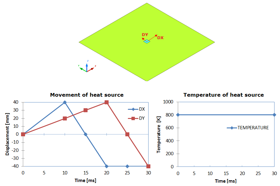

Figure 2. Problem Description
Units: mm, ms, g, N, and MPa

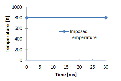

Figure 3. Imposed Temperature for Heat Source
