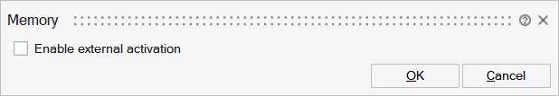

The Memory block keeps the input value and delays it by an integration time step.
externalActivation | Enable external activation | This parameter specifies whether the block receives an external activation or inherits its activation through its regular inputs. When External Activation is used, a additional activation port is added to the block. Default is OFF. | Number | 0 |
