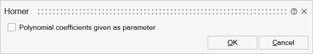

This block evaluates a polynomial using the Horner method. Polynomial coefficients may be constant and given as block parameters or variable given by the second input.
Activate/MathOperations
The Horner block evaluates a polynomial where the argument is an input and the result of the evaluation, the output. The polynomial coefficients may be given as a vector block parameter or as a second input vector. The coefficients of the polynomial are arranged in the vector in descending order (the last vector entry thus corresponding to the constant term). The argument may be a matrix. The polynomial is evaluated for each element of the input matrix separately producing as output a matrix of identical size. Double and complex data types are supported.
mode | Polynomial coefficients given as parameter | Number | 0 | |
coeffs | Polynomial coefficients | Vector |
u | explicit | input | 1 | |
Port 2 | explicit | input | 1-mode | |
p(u) | explicit | output | 1 |
