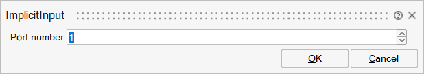

Placed in the diagram of a super block, the ImplicitInput block adds an implicit input port to the super block for linking implicit signals outside of the super block to blocks inside of the super block. Any link, outside of the super block, that is connected to the implicit input port extends to the corresponding ImplicitInput block inside of the super block.The parameter "Port number" determines the relationship between the port block and the port on the super block. By default, the input ports are numbered sequentially from top to bottom.
| portNumber | Port number | Number |
