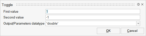

In this block, at each activation the output is toggled between quot;Firstquot; and quot;Secondquot; values. This action is useful for generating non periodic square wave signals.
Activate/SignalGenerators
In the Toggle block, at each activation the output is toggled between the first and the second values. This action is useful for generating non periodic square wave signals. This block is also useful to generate synchronous square waves with SampleClock activation.
firstvalue | First value | First value to toggle the signal. Default: 1. | Matrix | |
secondvalue | Second value | Second value to toggle the signal. Default: -1. | Matrix | |
ot | Output/Parameters datatype | Datatype of the output. Default: 'double'. | String | 'double' |
