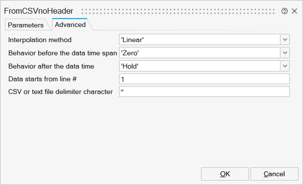

Method | Interpolation method | Defines how to interpolate the data that is read in from the .csv file. | String | 'ZeroOrder' |
Leftside | Behavior before the data time span | String | 'Zero' | |
Rightside | Behavior after the data time | String | 'Zero' | |
Offset | Data starts from line # | Line from which to start reading the .csv file. Default is 1. | Scalar | |
Separator | CSV or text file delimiter character | Enter a separator character in this field. If the field is left empty, Activate considers the first character following the variable time in the first line as the CSV separator. | String |
