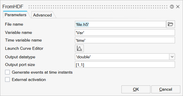

fname | File name | Full filename, with path, of the HDF5 input file. | String | |
varname | Variable name | Name of the variable to store the signal values. | String | |
timename | Time variable name | Name of the variable to store the signal time values. | String | |
typ | Output datatype | Defines the datatype of the output of the block. Available datatypes are : double, int32, int16, int8, unit32, uint16, uint8. | String | 'double' |
outsize | Output port size | Size of output port. | Matrix | |
outevent | Generate events at time instants | Specifies if the block generates an activation event. When OutEvent is used, an additional event output port is added to the block. Default is off. | Number | 0 |
externalActivation | External activation | Specifies whether the block receives an external activation or inherits its activation through its regular input ports. When External Activation is selected, an additional activation port is added to the block. By default, external activation is not selected. | Number | 0 |

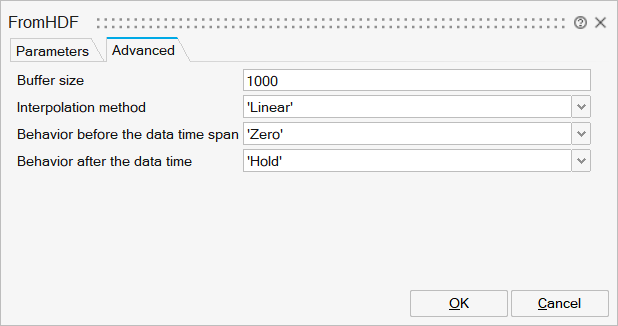

Buffer | Buffer size | Scalar | ||
Method | Interpolation method | String | 'ZeroOrder(floor)' | |
Leftside | Behavior before the data time span | String | 'Zero' | |
Rightside | Behavior after the data time | String | 'Zero' |
