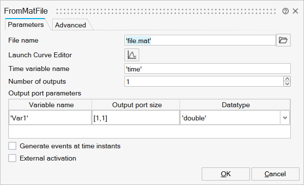

fname | File name | Defines the name (path and full name, in between quotes) of the input .mat file. | String | |
timename | Time variable name | Name of the variable in the data structure that contains the time values. If no name is provided, the time variable is not exported. | String | |
nout | Number of outputs | Number of data channels to be read in the MAT file.Their dimension must be consistent with the dimension on the Time variable. | Number | |
outports | Output port parameters | Structure | ||
outports/varname | Variable name | Cell of strings | ||
outports/outsize | Output port size | Cell of matrices | ||
outports/ot | Datatype | Cell of strings | 'double' | |
outevent | Generate events at time instants | This parameter defines if the block generates an activation event. When OutEvent is used, a additional event output port is added to the block. default is OFF. | Number | 0 |
externalActivation | External activation | Specifies whether the block receives an external activation or inherits its activation through its regular input ports. When External Activation is selected, an additional activation port is added to the block. By default, external activation is not selected. | Number | 0 |
Buffer | Buffer size | Scalar | ||

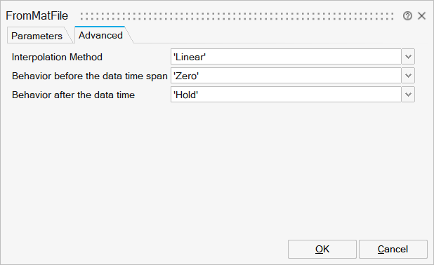

Method | Interpolation Method | Defines how the data read in is interpolated. Options are "zero order" or "linear". | String | 'ZeroOrder(floor)' |
Leftside | Behavior before the data time span | String | 'Zero' | |
Rightside | Behavior after the data time | String | 'Zero' |
