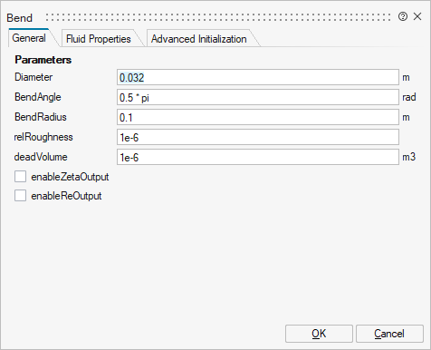

mo_Diameter | Diameter | Diameter | Scalar | |
mo_BendAngle | BendAngle | Bend angle | Scalar | |
mo_BendRadius | BendRadius | Bend radius | Scalar | |
mo_relRoughness | relRoughness | Relative roughness | Scalar | |
mo_deadVolume | deadVolume | Dead volume at ports | Scalar | |
mo_enableZetaOutput | enableZetaOutput | Enable zeta output | Number | 0 |
mo_enableReOutput | enableReOutput | Enable Re output | Number | 0 |

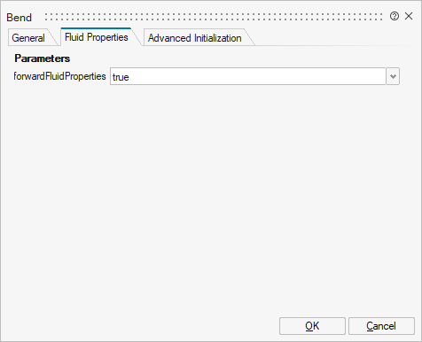

mo_forwardFluidProperties | forwardFluidProperties | Forward fluid properties between ports | Scalar | true |

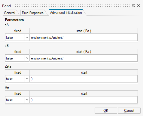

mo_pA/start | start | Cell of scalars | ||
mo_pB | pB | pB | Structure | |
mo_pB/fixed | fixed | Cell of scalars | true | |
mo_pB/start | start | Cell of scalars | ||
mo_Zeta | Zeta | Zeta | Structure | |
mo_Zeta/fixed | fixed | Cell of scalars | true | |
mo_Zeta/start | start | Cell of scalars | ||
mo_Re | Re | Re | Structure | |
mo_Re/fixed | fixed | Cell of scalars | true | |
mo_Re/start | start | Cell of scalars |
