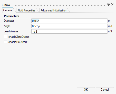

The component Elbow is a valid model for Elbow angle between 30° and 120°.
Please consider: The component was modeled in order to consider the pressure losses of sharp edged elbows. However, the use of the component can lead to extremely long simulation times, since a small stepsize must be selected due to the low resistance of an elbow.
Formulas are taken from W. Wagner, Strömung und Druckverlust, 7. Auflage 2012, and Will, D., Hydraulik, Grundlagen, Komponenten, Schaltungen, 5. Auflage 2011.
mo_Diameter | Diameter | Diameter | Scalar | |
mo_Angle | Angle | Elbow angle | Scalar | |
mo_deadVolume | deadVolume | Dead volume at ports | Scalar | |
mo_enableZetaOutput | enableZetaOutput | Enable zeta output | Number | 0 |
mo_enableReOutput | enableReOutput | Enable Re output | Number | 0 |

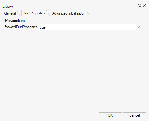

mo_forwardFluidProperties | forwardFluidProperties | Forward fluid properties between ports | Scalar | true |

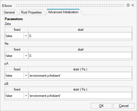

mo_Zeta | Zeta | Zeta | Structure | |
mo_Zeta/fixed | fixed | Cell of scalars | true | |
mo_Zeta/start | start | Cell of scalars | ||
mo_Re | Re | Re | Structure | |
mo_Re/fixed | fixed | Cell of scalars | true | |
mo_Re/start | start | Cell of scalars | ||
mo_pA/start | start | Cell of scalars | ||
mo_pB | pB | pB | Structure | |
mo_pB/fixed | fixed | Cell of scalars | true | |
mo_pB/start | start | Cell of scalars |
