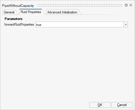

mo_forwardFluidProperties | forwardFluidProperties | Forward fluid properties between ports | Scalar | true |

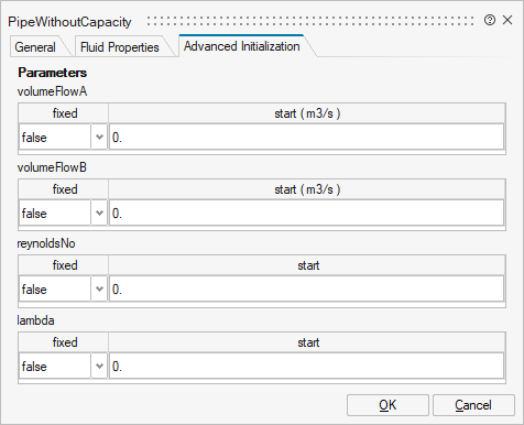

mo_volumeFlowA | volumeFlowA | volumeFlowA | Structure | |
mo_volumeFlowA/fixed | fixed | Cell of scalars | true | |
mo_volumeFlowA/start | start | Cell of scalars | ||
mo_volumeFlowB | volumeFlowB | volumeFlowB | Structure | |
mo_volumeFlowB/fixed | fixed | Cell of scalars | true | |
mo_volumeFlowB/start | start | Cell of scalars | ||
mo_reynoldsNo | reynoldsNo | reynoldsNo | Structure | |
mo_reynoldsNo/fixed | fixed | Cell of scalars | true | |
mo_reynoldsNo/start | start | Cell of scalars | ||
mo_lambda | lambda | lambda | Structure | |
mo_lambda/fixed | fixed | Cell of scalars | true | |
mo_lambda/start | start | Cell of scalars |
