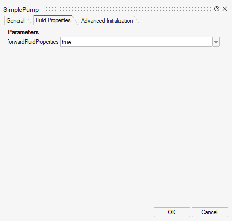

mo_forwardFluidProperties | forwardFluidProperties | Forward fluid properties between ports | Scalar | true |

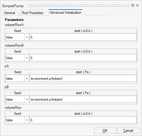

mo_pA/start | start | Cell of scalars | ||
mo_pB | pB | pB | Structure | |
mo_pB/fixed | fixed | Cell of scalars | true | |
mo_pB/start | start | Cell of scalars | ||
mo_volumeFlow | volumeFlow | volumeFlow | Structure | |
mo_volumeFlow/fixed | fixed | Cell of scalars | true | |
mo_volumeFlow/start | start | Cell of scalars |
