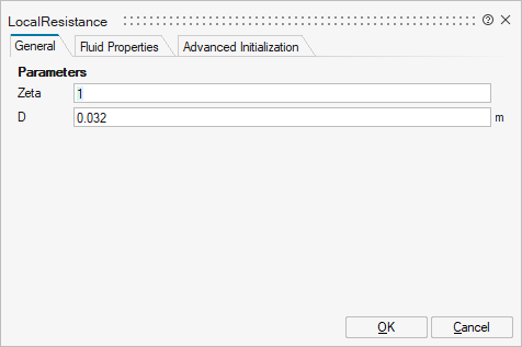

mo_Zeta | Zeta | Pressure loss coefficient | Scalar | |
mo_D | D | Diameter | Scalar | |

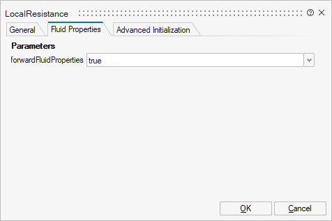

mo_forwardFluidProperties | forwardFluidProperties | Forward fluid properties between ports | Scalar | true |
