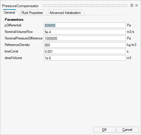

mo_pDifferential | pDifferential | Differential pressure | Scalar | |
mo_NominalVolumeFlow | NominalVolumeFlow | Nominal volume flow | Scalar | |
mo_NominalPressureDifference | NominalPressureDifference | Nominal pressure difference | Scalar | |
mo_ReferenceDensity | ReferenceDensity | Reference density for volume flow and pressure difference | Scalar | |
mo_timeConst | timeConst | Response time of valve spool | Scalar | |
mo_deadVolume | deadVolume | Dead volume at ports | Scalar |

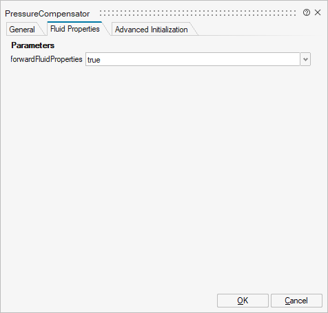

mo_forwardFluidProperties | forwardFluidProperties | Forward fluid properties between ports | Scalar | true |

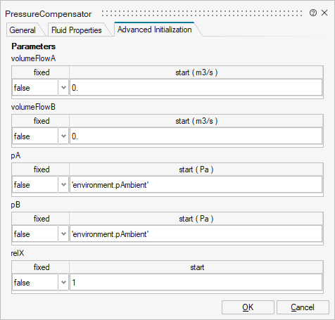

mo_volumeFlowA | volumeFlowA | volumeFlowA | Structure | |
mo_volumeFlowA/fixed | fixed | Cell of scalars | true | |
mo_volumeFlowA/start | start | Cell of scalars | ||
mo_volumeFlowB | volumeFlowB | volumeFlowB | Structure | |
mo_volumeFlowB/fixed | fixed | Cell of scalars | true | |
mo_volumeFlowB/start | start | Cell of scalars | ||
mo_pA/start | start | Cell of scalars | ||
mo_pB | pB | pB | Structure | |
mo_pB/fixed | fixed | Cell of scalars | true | |
mo_pB/start | start | Cell of scalars | ||
mo_relX | relX | relX | Structure | |
mo_relX/fixed | fixed | Cell of scalars | true | |
mo_relX/start | start | Cell of scalars |
