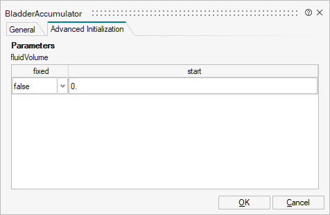

mo_fluidVolume | fluidVolume | fluidVolume | Structure | |
mo_fluidVolume/fixed | fixed | Cell of scalars | true | |
mo_fluidVolume/start | start | Cell of scalars |
