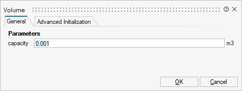

mo_capacity | capacity | Size of the volume | Scalar |

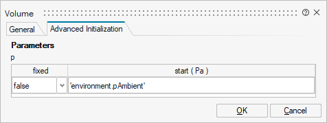

mo_p | p | p | Structure | |
mo_p/fixed | fixed | Cell of scalars | true | |
mo_p/start | start | Cell of scalars |
