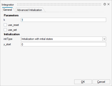

mo_k | k | Integrator gain | Scalar | |
mo_use_reset | use_reset | =true, if reset port enabled | Number | 0 |
mo_use_set | use_set | =true, if set port enabled and used as reinitialization value when reset | Number | 0 |
mo_initType | initType | Type of initialization (1: no init, 2: steady state, 3,4: initial output) | Structure | |
mo_initType/choice1 | No initialization (start values are used as guess values with fixed=false) | Number | 0 | |
mo_initType/choice2 | Steady state initialization (derivatives of states are zero) | Number | 0 | |
mo_initType/choice3 | Initialization with initial states | Number | 0 | |
mo_initType/choice4 | Initialization with initial outputs (and steady state of the states if possible) | Number | 0 | |
mo_y_start | y_start | Initial or guess value of output (= state) | Scalar |

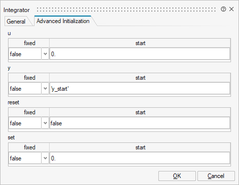

mo_u | u | u | Structure | |
mo_u/fixed | fixed | Cell of scalars | true | |
mo_u/start | start | Cell of scalars | ||
mo_y | y | y | Structure | |
mo_y/fixed | fixed | Cell of scalars | true | |
mo_y/start | start | Cell of scalars | ||
mo_reset | reset | reset | Structure | |
mo_reset/fixed | fixed | Cell of scalars | true | |
mo_reset/start | start | Cell of scalars | ||
mo_set | set | set | Structure | |
mo_set/fixed | fixed | Cell of scalars | true | |
mo_set/start | start | Cell of scalars |
