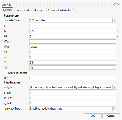

mo_controllerType | controllerType | Type of controller | Structure | |
mo_controllerType/choice1 | P controller | Number | 0 | |
mo_controllerType/choice2 | PI controller | Number | 0 | |
mo_controllerType/choice3 | PD controller | Number | 0 | |
mo_controllerType/choice4 | PID controller | Number | 0 | |
mo_k | k | Gain of controller | Scalar | |
mo_Ti | Ti | Time constant of Integrator block | Scalar | |
mo_Td | Td | Time constant of Derivative block | Scalar | |
mo_yMax | yMax | Upper limit of output | Scalar | |
mo_yMin | yMin | Lower limit of output | Scalar | |
mo_wp | wp | Set-point weight for Proportional block (0..1) | Scalar | |
mo_wd | wd | Set-point weight for Derivative block (0..1) | Scalar | |
mo_Ni | Ni | Ni*Ti is time constant of anti-windup compensation | Scalar | |
mo_Nd | Nd | The higher Nd, the more ideal the derivative block | Scalar | |
mo_withFeedForward | withFeedForward | Use feed-forward input? | Number | 0 |
mo_kFF | kFF | Gain of feed-forward input | Scalar | |
mo_initType | initType | Type of initialization (1: no init, 2: steady state, 3: initial state, 4: initial output) | Structure | |
mo_initType/choice1 | No initialization (start values are used as guess values with fixed=false) | Number | 0 | |
mo_initType/choice2 | Steady state initialization (derivatives of states are zero) | Number | 0 | |
mo_initType/choice3 | Initialization with initial states | Number | 0 | |
mo_initType/choice4 | Initialization with initial outputs (and steady state of the states if possible) | Number | 0 | |
mo_initType/choice5 | Do not use, only for backward compatibility (initialize only integrator state) | Number | 0 | |
mo_xi_start | xi_start | Initial or guess value for integrator output (= integrator state) | Scalar | |
mo_xd_start | xd_start | Initial or guess value for state of derivative block | Scalar | |
mo_y_start | y_start | Initial value of output | Scalar | |

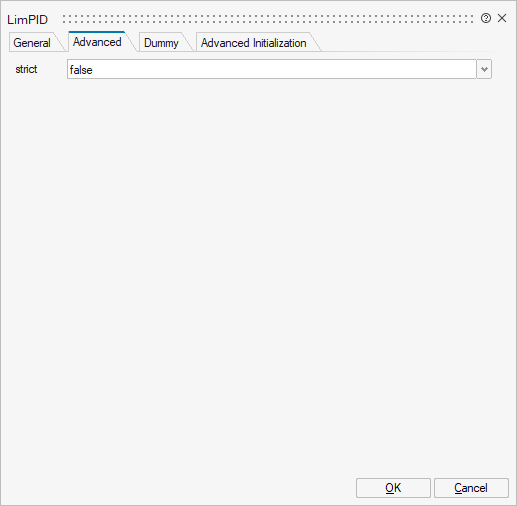

mo_strict | strict | = true, if strict limits with noEvent(..) | Scalar | true |

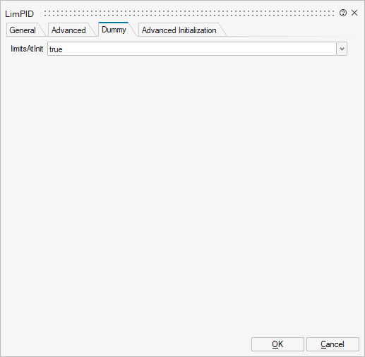

mo_limitsAtInit | limitsAtInit | Has no longer an effect and is only kept for backwards compatibility (the implementation uses now the homotopy operator) | Scalar | true |

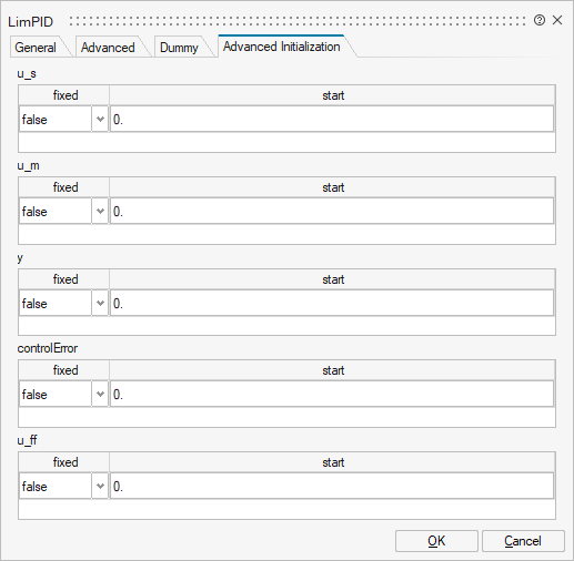

mo_u_s | u_s | u_s | Structure | |
mo_u_s/fixed | fixed | Cell of scalars | true | |
mo_u_s/start | start | Cell of scalars | ||
mo_u_m | u_m | u_m | Structure | |
mo_u_m/fixed | fixed | Cell of scalars | true | |
mo_u_m/start | start | Cell of scalars | ||
mo_y | y | y | Structure | |
mo_y/fixed | fixed | Cell of scalars | true | |
mo_y/start | start | Cell of scalars | ||
mo_controlError | controlError | controlError | Structure | |
mo_controlError/fixed | fixed | Cell of scalars | true | |
mo_controlError/start | start | Cell of scalars | ||
mo_u_ff | u_ff | u_ff | Structure | |
mo_u_ff/fixed | fixed | Cell of scalars | true | |
mo_u_ff/start | start | Cell of scalars |
