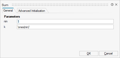

parameter: nin = 3;
results in the following equations:
y = u[1] + u[2] + u[3];
mo_nin | nin | Number of inputs | Scalar | |
mo_k | k | Optional: sum coefficients | Vector |

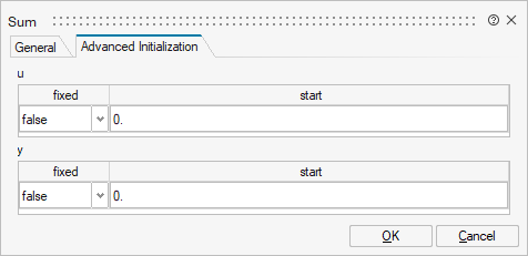

mo_u | u | u | Structure | |
mo_u/fixed | fixed | Cell of vectors | true | |
mo_u/start | start | Cell of vectors | ||
mo_y | y | y | Structure | |
mo_y/fixed | fixed | Cell of scalars | true | |
mo_y/start | start | Cell of scalars |
