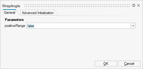

This blocks wraps the input angle into the interval ]-pi,pi], if positiveRange == false.
Otherwise the input angle u is wrapped to the interval [0,2*pi[.
mo_positiveRange | positiveRange | Use only positive output range, if true | Scalar | true |

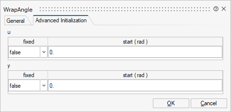

mo_u | u | u | Structure | |
mo_u/fixed | fixed | Cell of scalars | true | |
mo_u/start | start | Cell of scalars | ||
mo_y | y | y | Structure | |
mo_y/fixed | fixed | Cell of scalars | true | |
mo_y/start | start | Cell of scalars |
