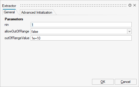

mo_nin | nin | Number of inputs | Scalar | |
mo_allowOutOfRange | allowOutOfRange | Index may be out of range | Scalar | true |
mo_outOfRangeValue | outOfRangeValue | Output signal if index is out of range | Scalar |

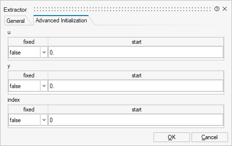

mo_u | u | u | Structure | |
mo_u/fixed | fixed | Cell of vectors | true | |
mo_u/start | start | Cell of vectors | ||
mo_y | y | y | Structure | |
mo_y/fixed | fixed | Cell of scalars | true | |
mo_y/start | start | Cell of scalars | ||
mo_index | index | index | Structure | |
mo_index/fixed | fixed | Cell of scalars | true | |
mo_index/start | start | Cell of scalars |
