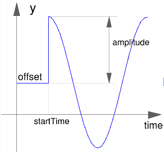

The Real output y is a cosine signal:

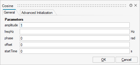

mo_amplitude | amplitude | Amplitude of cosine wave | Scalar | |
mo_freqHz | freqHz | Frequency of cosine wave | Scalar | |
mo_phase | phase | Phase of cosine wave | Scalar | |
mo_offset | offset | Offset of output signal y | Scalar | |
mo_startTime | startTime | Output y = offset for time < startTime | Scalar |

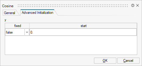

mo_y | y | y | Structure | |
mo_y/fixed | fixed | Cell of scalars | true | |
mo_y/start | start | Cell of scalars |
