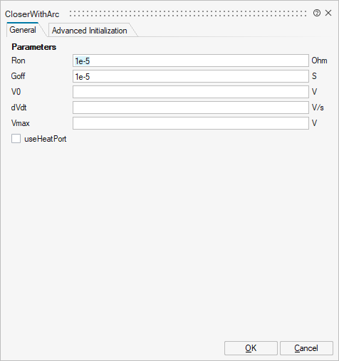

This model is an extension to the IdealClosingSwitch.
For details of the arc effect, see partial model IdealSwitchWithArc.
mo_Ron | Ron | Closed switch resistance | Scalar | |
mo_Goff | Goff | Opened switch conductance | Scalar | |
mo_V0 | V0 | Initial arc voltage | Scalar | |
mo_dVdt | dVdt | Arc voltage slope | Scalar | |
mo_Vmax | Vmax | Max. arc voltage | Scalar | |
mo_T | T | Fixed device temperature if useHeatPort = false | Scalar |

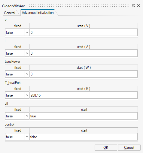

mo_v | v | v | Structure | |
mo_v/fixed | fixed | Cell of scalars | true | |
mo_v/start | start | Cell of scalars | ||
mo_i | i | i | Structure | |
mo_i/fixed | fixed | Cell of scalars | true | |
mo_i/start | start | Cell of scalars | ||
mo_LossPower | LossPower | LossPower | Structure | |
mo_LossPower/fixed | fixed | Cell of scalars | true | |
mo_LossPower/start | start | Cell of scalars | ||
mo_T_heatPort | T_heatPort | T_heatPort | Structure | |
mo_T_heatPort/fixed | fixed | Cell of scalars | true | |
mo_T_heatPort/start | start | Cell of scalars | ||
mo_off | off | off | Structure | |
mo_off/fixed | fixed | Cell of scalars | true | |
mo_off/start | start | Cell of scalars | ||
mo_control | control | control | Structure | |
mo_control/fixed | fixed | Cell of scalars | true | |
mo_control/start | start | Cell of scalars |
