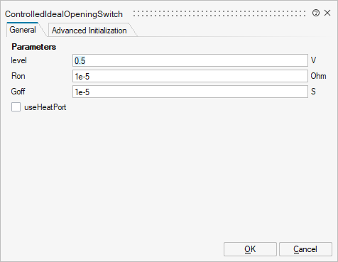

The switching behaviour of the controlled ideal opening switch is controlled by the control pin: off = control.v > level
For further details, see partial model IdealSwitch.
mo_level | level | Switch level | Scalar | |
mo_Ron | Ron | Closed switch resistance | Scalar | |
mo_Goff | Goff | Opened switch conductance | Scalar | |
mo_T | T | Fixed device temperature if useHeatPort = false | Scalar | |
mo_unitVoltage | unitVoltage | Scalar | ||
mo_unitCurrent | unitCurrent | Scalar |

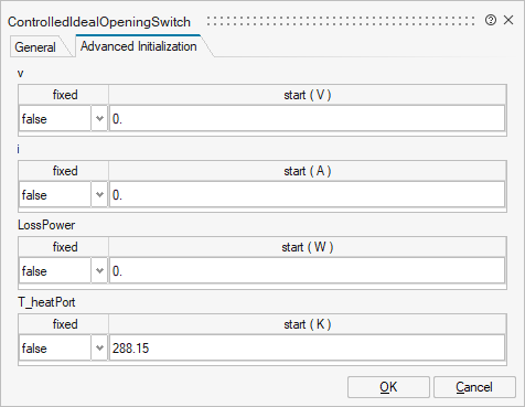

mo_v | v | v | Structure | |
mo_v/fixed | fixed | Cell of scalars | true | |
mo_v/start | start | Cell of scalars | ||
mo_i | i | i | Structure | |
mo_i/fixed | fixed | Cell of scalars | true | |
mo_i/start | start | Cell of scalars | ||
mo_LossPower | LossPower | LossPower | Structure | |
mo_LossPower/fixed | fixed | Cell of scalars | true | |
mo_LossPower/start | start | Cell of scalars | ||
mo_T_heatPort | T_heatPort | T_heatPort | Structure | |
mo_T_heatPort/fixed | fixed | Cell of scalars | true | |
mo_T_heatPort/start | start | Cell of scalars |
