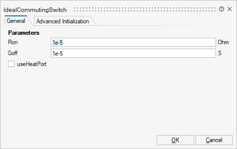

mo_Ron | Ron | Closed switch resistance | Scalar | |
mo_Goff | Goff | Opened switch conductance | Scalar | |
mo_T | T | Fixed device temperature if useHeatPort = false | Scalar | |
mo_unitVoltage | unitVoltage | Scalar | ||
mo_unitCurrent | unitCurrent | Scalar |

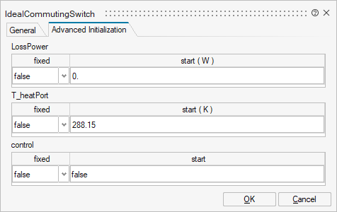

mo_LossPower | LossPower | LossPower | Structure | |
mo_LossPower/fixed | fixed | Cell of scalars | true | |
mo_LossPower/start | start | Cell of scalars | ||
mo_T_heatPort | T_heatPort | T_heatPort | Structure | |
mo_T_heatPort/fixed | fixed | Cell of scalars | true | |
mo_T_heatPort/start | start | Cell of scalars | ||
mo_control | control | control | Structure | |
mo_control/fixed | fixed | Cell of scalars | true | |
mo_control/start | start | Cell of scalars |
