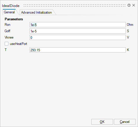

This is an ideal diode, for details see partial model IdealSemiconductor
The diode is conducting if voltage > Vknee.
The diode is locking if current < Vknee/Goff.
mo_Ron | Ron | Forward state-on differential resistance (closed resistance) | Scalar | |
mo_Goff | Goff | Backward state-off conductance (opened conductance) | Scalar | |
mo_Vknee | Vknee | Forward threshold voltage | Scalar | |
mo_T | T | Fixed device temperature if useHeatPort = false | Scalar | |
mo_unitVoltage | unitVoltage | Scalar | ||
mo_unitCurrent | unitCurrent | Scalar |

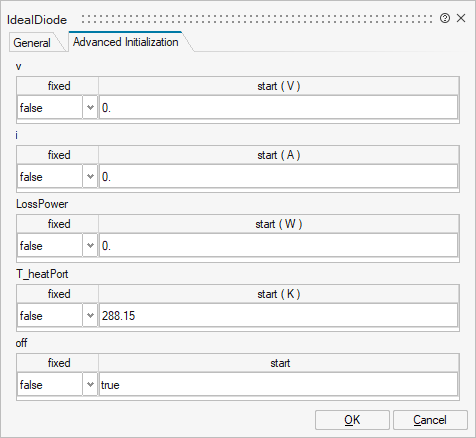

mo_v | v | v | Structure | |
mo_v/fixed | fixed | Cell of scalars | true | |
mo_v/start | start | Cell of scalars | ||
mo_i | i | i | Structure | |
mo_i/fixed | fixed | Cell of scalars | true | |
mo_i/start | start | Cell of scalars | ||
mo_LossPower | LossPower | LossPower | Structure | |
mo_LossPower/fixed | fixed | Cell of scalars | true | |
mo_LossPower/start | start | Cell of scalars | ||
mo_T_heatPort | T_heatPort | T_heatPort | Structure | |
mo_T_heatPort/fixed | fixed | Cell of scalars | true | |
mo_T_heatPort/start | start | Cell of scalars | ||
mo_off | off | off | Structure | |
mo_off/fixed | fixed | Cell of scalars | true | |
mo_off/start | start | Cell of scalars |
