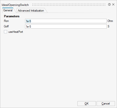

IdealOpeningSwitch
Ideal electrical opener
Modelica/Electrical/Analog/Ideal
The switching behaviour of the ideal opening switch is controlled by the input signal control: off = control.
For further details, see partial model IdealSwitch.
mo_Ron | Ron | Closed switch resistance | Scalar | |
mo_Goff | Goff | Opened switch conductance | Scalar | |
mo_T | T | Fixed device temperature if useHeatPort = false | Scalar | |
mo_unitVoltage | unitVoltage | Scalar | ||
mo_unitCurrent | unitCurrent | Scalar |
