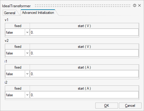

mo_v1 | v1 | v1 | Structure | |
mo_v1/fixed | fixed | Cell of scalars | true | |
mo_v1/start | start | Cell of scalars | ||
mo_v2 | v2 | v2 | Structure | |
mo_v2/fixed | fixed | Cell of scalars | true | |
mo_v2/start | start | Cell of scalars | ||
mo_i1 | i1 | i1 | Structure | |
mo_i1/fixed | fixed | Cell of scalars | true | |
mo_i1/start | start | Cell of scalars | ||
mo_i2 | i2 | i2 | Structure | |
mo_i2/fixed | fixed | Cell of scalars | true | |
mo_i2/start | start | Cell of scalars |
