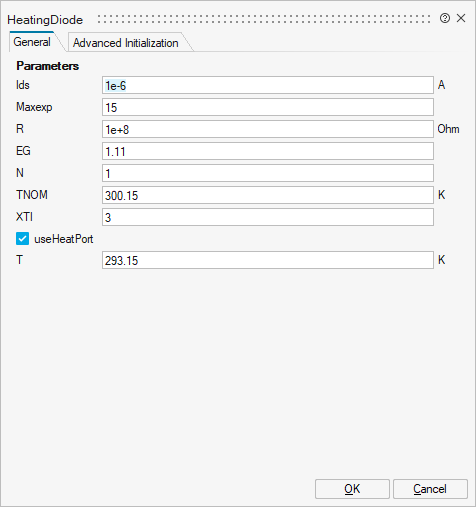

mo_Ids | Ids | Saturation current | Scalar | |
mo_Maxexp | Maxexp | Max. exponent for linear continuation | Scalar | |
mo_R | R | Parallel ohmic resistance | Scalar | |
mo_EG | EG | Activation energy | Scalar | |
mo_N | N | Emission coefficient | Scalar | |
mo_TNOM | TNOM | Parameter measurement temperature | Scalar | |
mo_XTI | XTI | Temperature exponent of saturation current | Scalar | |
mo_T | T | Fixed device temperature if useHeatPort = false | Scalar |

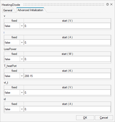

mo_v | v | v | Structure | |
mo_v/fixed | fixed | Cell of scalars | true | |
mo_v/start | start | Cell of scalars | ||
mo_i | i | i | Structure | |
mo_i/fixed | fixed | Cell of scalars | true | |
mo_i/start | start | Cell of scalars | ||
mo_LossPower | LossPower | LossPower | Structure | |
mo_LossPower/fixed | fixed | Cell of scalars | true | |
mo_LossPower/start | start | Cell of scalars | ||
mo_T_heatPort | T_heatPort | T_heatPort | Structure | |
mo_T_heatPort/fixed | fixed | Cell of scalars | true | |
mo_T_heatPort/start | start | Cell of scalars | ||
mo_vt_t | vt_t | vt_t | Structure | |
mo_vt_t/fixed | fixed | Cell of scalars | true | |
mo_vt_t/start | start | Cell of scalars | ||
mo_id | id | id | Structure | |
mo_id/fixed | fixed | Cell of scalars | true | |
mo_id/start | start | Cell of scalars |
