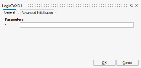

mo_n | n | signal width | Scalar |

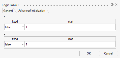

mo_x | x | x | Structure | |
mo_x/fixed | fixed | Cell of vectors | true | |
mo_x/start | start | Cell of vectors | ||
mo_y | y | y | Structure | |
mo_y/fixed | fixed | Cell of vectors | true | |
mo_y/start | start | Cell of vectors |
