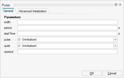

mo_width | width | Widths of pulses in % of periods | Scalar | |
mo_period | period | Time for one period | Scalar | |
mo_startTime | startTime | Output = quiet for time < startTime | Scalar | |
mo_pulse | pulse | pulsed value | Structure | |
mo_pulse/choice1 | U Uninitialized | Number | 0 | |
mo_pulse/choice2 | X Forcing Unknown | Number | 0 | |
mo_pulse/choice3 | 0 Forcing 0 | Number | 0 | |
mo_pulse/choice4 | 1 Forcing 1 | Number | 0 | |
mo_pulse/choice5 | Z High Impedance | Number | 0 | |
mo_pulse/choice6 | W Weak Unknown | Number | 0 | |
mo_pulse/choice7 | L Weak 0 | Number | 0 | |
mo_pulse/choice8 | H Weak 1 | Number | 0 | |
mo_pulse/choice9 | - Do not care | Number | 0 | |
mo_quiet | quiet | quiet value | Structure | |
mo_quiet/choice1 | U Uninitialized | Number | 0 | |
mo_quiet/choice2 | X Forcing Unknown | Number | 0 | |
mo_quiet/choice3 | 0 Forcing 0 | Number | 0 | |
mo_quiet/choice4 | 1 Forcing 1 | Number | 0 | |
mo_quiet/choice5 | Z High Impedance | Number | 0 | |
mo_quiet/choice6 | W Weak Unknown | Number | 0 | |
mo_quiet/choice7 | L Weak 0 | Number | 0 | |
mo_quiet/choice8 | H Weak 1 | Number | 0 | |
mo_quiet/choice9 | - Do not care | Number | 0 | |
mo_nperiod | nperiod | Number of periods (< 0 means infinite number of periods) | Scalar |

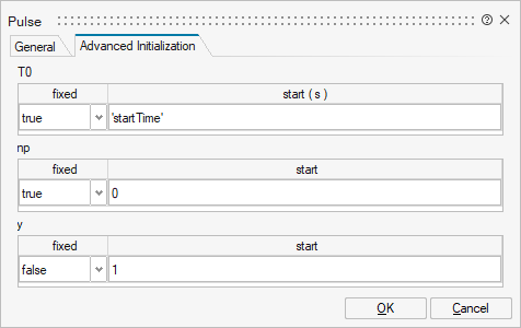

mo_T0 | T0 | T0 | Structure | |
mo_T0/fixed | fixed | Cell of scalars | true | |
mo_T0/start | start | Cell of scalars | ||
mo_np | np | np | Structure | |
mo_np/fixed | fixed | Cell of scalars | true | |
mo_np/start | start | Cell of scalars | ||
mo_y | y | y | Structure | |
mo_y/fixed | fixed | Cell of scalars | true | |
mo_y/start | start | Cell of scalars |
