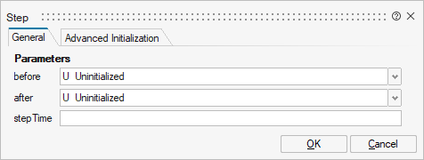

The step source output signal steps from the value before to the value after at the time stepTime.
To specify the logic value parameters, the integer code has to be used.

If the logic values are imported by
import L = Digital.Interfaces.Logic;
they can be used to specify the parameter, e.g., L.'0' for forcing 0.
mo_before | before | Logic value before step | Structure | |
mo_before/choice1 | U Uninitialized | Number | 0 | |
mo_before/choice2 | X Forcing Unknown | Number | 0 | |
mo_before/choice3 | 0 Forcing 0 | Number | 0 | |
mo_before/choice4 | 1 Forcing 1 | Number | 0 | |
mo_before/choice5 | Z High Impedance | Number | 0 | |
mo_before/choice6 | W Weak Unknown | Number | 0 | |
mo_before/choice7 | L Weak 0 | Number | 0 | |
mo_before/choice8 | H Weak 1 | Number | 0 | |
mo_before/choice9 | - Do not care | Number | 0 | |
mo_after | after | Logic value after step | Structure | |
mo_after/choice1 | U Uninitialized | Number | 0 | |
mo_after/choice2 | X Forcing Unknown | Number | 0 | |
mo_after/choice3 | 0 Forcing 0 | Number | 0 | |
mo_after/choice4 | 1 Forcing 1 | Number | 0 | |
mo_after/choice5 | Z High Impedance | Number | 0 | |
mo_after/choice6 | W Weak Unknown | Number | 0 | |
mo_after/choice7 | L Weak 0 | Number | 0 | |
mo_after/choice8 | H Weak 1 | Number | 0 | |
mo_after/choice9 | - Do not care | Number | 0 | |

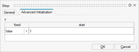

mo_stepTime | stepTime | step time | Scalar |
mo_y | y | y | Structure | |
mo_y/fixed | fixed | Cell of scalars | true | |
mo_y/start | start | Cell of scalars |
y | implicit | output | 1 |
